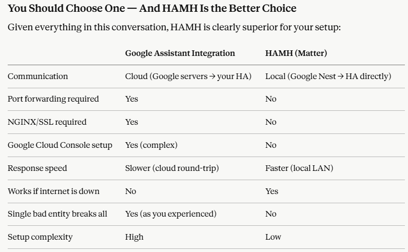

FINAL SOLUTION as highlighted by @User87 - deactivate and unlink google assistant from Google Home and install HAMH. It is so much better that it just doesnt make sense to keep google assistant if you can expose your entities to HAMH (wish I knew this two weeks ago)
  1. Use Home Assistant Matter Hub. Github repo
  2. Video reference
  3. Comparison
Note: voice commands still require a round-trip to Google's servers, but execution is done locally (faster)
