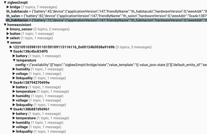

Here is a picture of the topics:
The sensors seem the be published properly, and for example, the content of the temperature config is:

For some reason home assistant is not showing the sensors, I've read the mqtt-discovery page and everything seems alright, unless the object_id in <discovery_prefix>//[<node_id>/]<object_id>/config needs to be unique, in which case I'm screwed because the unique part is in the "component".
