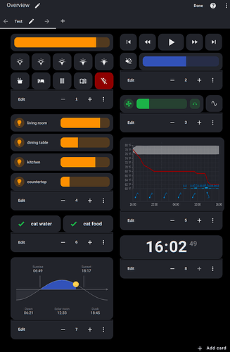

This is how my dashboard is rendering on my PC or Samsung Galaxy S10+ phone:

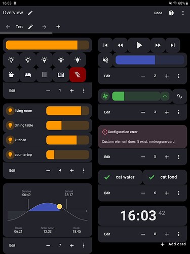

This is how my dashboard is rendering on my tablet:
You’ll observe that the Horizontal Stack and Vertical Stack cards are all rendering with zero margins between their cards, and my meteogram card resource isn’t found on my tablet despite being present in the resource list. When I try to add a card, Meteogram is available as a card on PC but not on my tablet.
The timeline was:
  1. Completely fresh factory tablet with HA install, and the horizontal and vertical stack cards initially had the aforepictured rendering error
  2. At some point in the course of setting things up, the tablet suddenly got a handle on things and started rendering the vertical and horizontal stacks with their proper margins. It also faithfully loaded the Meteogram card, and I spent quite a lot of time tweaking the javascript for an ideal tablet presentation.
  3. I installed the “WallPanel” HACS add-on and suddenly it reverted back to zero margins on the vertical and horizontal stacks, and suddenly couldn’t locate the meteogram card resource, despite never having touched anything related to that resource address, the javacript file itself, theme, or anything other than adding another lovelace resource with HACS.
Attempts at resolving this have included:
  • Removing WallPanel in HACS
  • Force closing and clearing cache on the tablet android app. When I was editing the meteogram resource file, this is how I was able to update the app and see the latest changes I’d made to the javascriopt resource
  • Restarting the tablet
  • Deleting all HA app data and signing back into the app
  • Uninstalling the HA app completely and reinsalling it
  • Reverting to the stock Meteogram resource from github
  • Restarting HA
  • Reverting the customized theme back to stock theme from github
  • Removing the Meteogram resource and then adding it again
  • Adding another HACS lovelace resource to try to trigger a resource reload
  • Rebooting the RP4 HA is installed on
Nothing matters except getting this setup to work correctly on the tablet, which has a physically excellent AMOLED screen, form factor and hardware performance for a “kiosk” style Home Assistant controller. I don’t think the issue has anything to do with WallPanel, so much as there is some weird issue with serving Lovelace dashboard resources given it’s now gone back and forth with the rendering issue and can’t locate a resource it had in cache perfectly before and could repeatedly retrieve it. I just can’t shake the tablet back out of its issue…

OH MY GOD IT WAS GOOGLE CHROME
At the same time as everything I was also disabling all the various irrelevant apps on the tablet, and given I use Firefox as a browser and have started to ‘degoogle’, I’d gone and “disabled” Chrome which reverted it to some truly ancient factory default.
I caught some slight whiff of a chrome dependency while continuing to Kagi this issue and I went ahead and renabled chrome and updated it in the Play store.
The rendering issues I spoke of are now SOLVED.
I hated figuring this out.
The companion app use Googles webview.
It is a browser extension that can be included in apps, but it is based on Chromium, like Chrome and it might get updated with Chrome.
If you own your device you can also install some ungoogled webview like cromite :green_circle:
