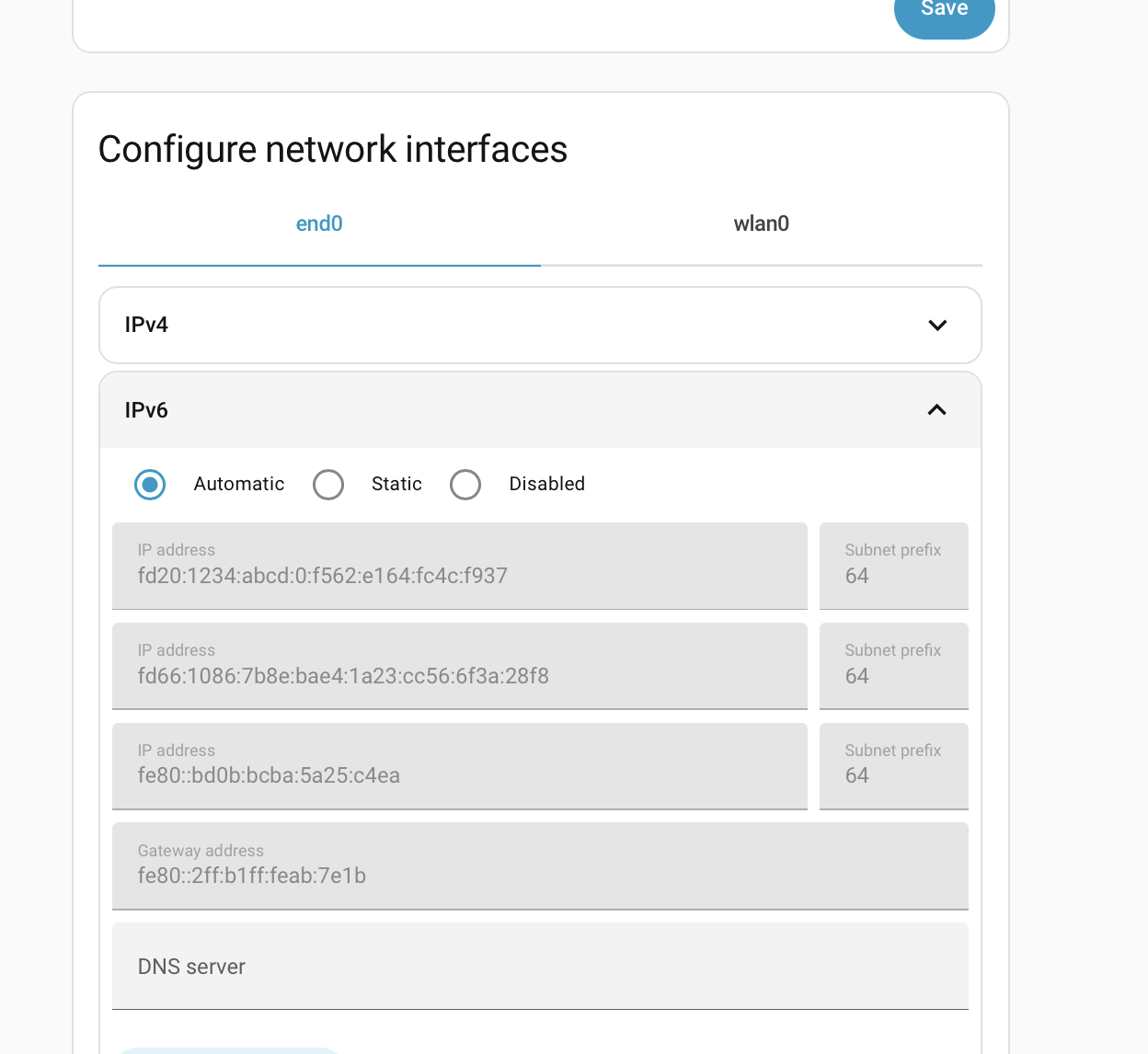

The latest HA updates made it really painful to connect devices with Matter/thread. :+1: :clap:
Check the HA UI->Settings->System->Network->IPv6 and make sure it is set to “auto”.
If it is, then for some odd reason, your system is not accepting Router Advertisements from the OTBR (or some other IPv6 router sending RAs). HAOS comes with this enabled.
You should be seeing a route something like:
fd12:1e52:b729:1::/64 via fe80::d748:345d:bd81:54ee proto ra metric 105 pref medium. Note the ra indicator.

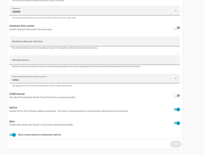

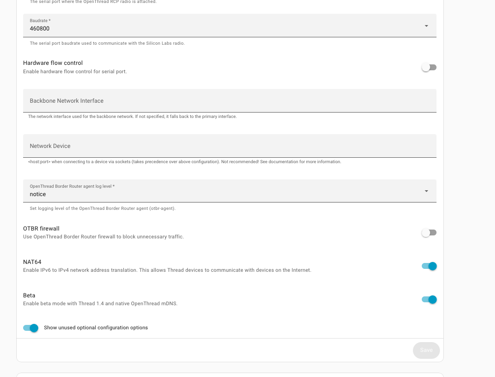

this is my current OBTR configuration. I don’t recall enabling that option anywhere.
Will investigate how that needs to be done.
Sure. I’ll update this thread later tonight when I’ve done the required digging.
I think this looks better now, right?
and this is the output of the ha network info command:

    inet6 fe80::c55:ddff:fe0b:2865/64 scope link
       valid_lft forever preferred_lft forever
[core-ssh ~]$ ip -6 addr
1: lo: <LOOPBACK,UP,LOWER_UP> mtu 65536 state UNKNOWN qlen 1000
    inet6 ::1/128 scope host
2: eth0@if13: <BROADCAST,MULTICAST,UP,LOWER_UP,M-DOWN> mtu 1500 state UP
    inet6 fd0c:ac1e:2100::8/48 scope global flags 02
[core-ssh ~]$ ip -6 route
fd0c:ac1e:2100::/48 dev eth0  metric 256
fe80::/64 dev eth0  metric 256
and for the record, this is the current configuration on my Fortigate:
config ipv6
    set ip6-address fd20:1234:abcd::1/64
    set ip6-send-adv enable
    set ip6-other-flag enable
    config ip6-prefix-list
        edit fd20:1234:abcd::/64
            set autonomous-flag enable
            set onlink-flag enable
            set valid-life-time 2592000
            set preferred-life-time 86400
        next
    end
end
I wonder where inet6 fd0c:ac1e:2100::8/48 scope global flags 02comes from…
This is the output that I see on Matter add-on:
s6-rc: info: service matter-server successfully stopped
s6-rc: info: service banner: stopping
s6-rc: info: service banner successfully stopped
s6-rc: info: service s6rc-oneshot-runner: stopping
s6-rc: info: service s6rc-oneshot-runner successfully stopped
s6-rc: info: service s6rc-oneshot-runner: starting
s6-rc: info: service s6rc-oneshot-runner successfully started
s6-rc: info: service fix-attrs: starting
s6-rc: info: service banner: starting
s6-rc: info: service fix-attrs successfully started
s6-rc: info: service legacy-cont-init: starting
s6-rc: info: service legacy-cont-init successfully started
 Add-on: Matter Server
 Matter WebSocket Server for Home Assistant Matter support.
 Add-on version: 8.4.0
 You are running the latest version of this add-on.
 System: Home Assistant OS 17.2  (aarch64 / raspberrypi4-64)
 Home Assistant Core: 2026.4.4
 Home Assistant Supervisor: 2026.04.0
 Please, share the above information when looking for help
 or support in, e.g., GitHub, forums or the Discord chat.
s6-rc: info: service banner successfully started
s6-rc: info: service matter-server: starting
s6-rc: info: service matter-server successfully started
[01:22:06] INFO: Starting Matter Server...
[01:22:06] INFO: Using Python Matter Server
[01:22:08] INFO: Using 'end0' as primary network interface.
[01:22:08] INFO: Successfully send discovery information to Home Assistant.
2026-04-26 01:22:14.855 (MainThread) INFO [matter_server.server.stack] Initializing CHIP/Matter Logging...
2026-04-26 01:22:14.856 (MainThread) INFO [matter_server.server.stack] Initializing CHIP/Matter Controller Stack...
[1777159334.929561][117:117] CHIP:CTL: Setting attestation nonce to random value
[1777159334.930107][117:117] CHIP:CTL: Setting CSR nonce to random value
[1777159334.931816][117:117] CHIP:DL: ChipLinuxStorage::Init: Using KVS config file: /tmp/chip_kvs
[1777159334.942113][117:117] CHIP:DL: Wrote settings to /tmp/chip_kvs
[1777159334.942672][117:117] CHIP:DL: ChipLinuxStorage::Init: Using KVS config file: /data/chip_factory.ini
[1777159334.943009][117:117] CHIP:DL: ChipLinuxStorage::Init: Using KVS config file: /data/chip_config.ini
[1777159334.943139][117:117] CHIP:DL: ChipLinuxStorage::Init: Using KVS config file: /data/chip_counters.ini
[1777159334.950113][117:117] CHIP:DL: Wrote settings to /data/chip_counters.ini
[1777159334.950200][117:117] CHIP:DL: NVS set: chip-counters/reboot-count = 25 (0x19)
[1777159334.951329][117:117] CHIP:DL: Got Ethernet interface: end0
[1777159334.952108][117:117] CHIP:DL: Found the primary Ethernet interface:end0
[1777159334.952859][117:117] CHIP:DL: Got WiFi interface: wlan0
[1777159334.952937][117:117] CHIP:DL: Failed to reset WiFi statistic counts
[1777159334.952956][117:117] CHIP:PAF: WiFiPAF: WiFiPAFLayer::Init()
2026-04-26 01:22:14.954 (MainThread) INFO [chip.storage] Initializing persistent storage from file: /data/chip.json
2026-04-26 01:22:14.954 (MainThread) INFO [chip.storage] Loading configuration from /data/chip.json...
2026-04-26 01:22:15.232 (MainThread) INFO [chip.CertificateAuthority] Loading certificate authorities from storage...
2026-04-26 01:22:15.233 (MainThread) INFO [chip.CertificateAuthority] New CertificateAuthority at index 1
2026-04-26 01:22:15.238 (MainThread) INFO [chip.CertificateAuthority] Loading fabric admins from storage...
2026-04-26 01:22:15.238 (MainThread) INFO [chip.FabricAdmin] New FabricAdmin: FabricId: 0x0000000000000002, VendorId = 0x134B
2026-04-26 01:22:15.239 (MainThread) INFO [matter_server.server.stack] CHIP Controller Stack initialized.
2026-04-26 01:22:15.240 (MainThread) INFO [matter_server.server.server] Matter Server initialized
2026-04-26 01:22:15.240 (MainThread) INFO [matter_server.server.server] Using 'end0' as primary interface (for link-local addresses)
2026-04-26 01:22:15.242 (MainThread) INFO [matter_server.server.server] Starting the Matter Server...
2026-04-26 01:22:15.253 (MainThread) INFO [matter_server.server.helpers.paa_certificates] Skip fetching certificates (already fetched within the last 24h).
2026-04-26 01:22:15.253 (MainThread) INFO [chip.FabricAdmin] Allocating new controller with CaIndex: 1, FabricId: 0x0000000000000002, NodeId: 0x000000000001B669, CatTags: []
2026-04-26 01:22:15.438 (Dummy-2) CHIP_ERROR [chip.native.DIS] Failed to advertise records: src/inet/UDPEndPointImplSockets.cpp:417: OS Error 0x02000065: Network is unreachable
2026-04-26 01:22:15.454 (Dummy-2) CHIP_ERROR [chip.native.DL] Long dispatch time: 198 ms, for event type 2
2026-04-26 01:22:15.479 (MainThread) INFO [matter_server.server.vendor_info] Loading vendor info from storage.
2026-04-26 01:22:15.501 (MainThread) INFO [matter_server.server.vendor_info] Loaded 419 vendors from storage.
2026-04-26 01:22:15.502 (MainThread) INFO [matter_server.server.vendor_info] Fetching the latest vendor info from DCL.
2026-04-26 01:22:15.900 (MainThread) INFO [matter_server.server.vendor_info] Fetched 418 vendors from DCL.
2026-04-26 01:22:15.901 (MainThread) INFO [matter_server.server.vendor_info] Saving vendor info to storage.
2026-04-26 01:22:15.924 (MainThread) INFO [matter_server.server.device_controller] Loaded 1 nodes from stored configuration
2026-04-26 01:22:15.938 (MainThread) INFO [matter_server.server.server] Matter Server successfully initialized.
2026-04-26 01:22:16.649 (MainThread) INFO [matter_server.server.device_controller.mdns] <Node:3> Discovered on mDNS
2026-04-26 01:22:16.650 (MainThread) INFO [matter_server.server.device_controller] <Node:3> Setting-up node...
2026-04-26 01:22:17.156 (MainThread) INFO [matter_server.server.device_controller.mdns] <Node:3> Discovered on mDNS
2026-04-26 01:22:18.159 (MainThread) INFO [matter_server.server.device_controller.mdns] <Node:3> Discovered on mDNS
2026-04-26 01:22:19.503 (MainThread) INFO [matter_server.server.device_controller] <Node:3> Setting up attributes and events subscription.
2026-04-26 01:22:22.889 (MainThread) INFO [matter_server.server.device_controller] <Node:3> Subscription succeeded with report interval [0, 900]
and this is the output that I see on the OTBR log:
[01:01:53] INFO: otbr-agent exited with code 0 (by signal 0).
Chain OTBR_FORWARD_INGRESS (0 references)
target     prot opt source               destination
ACCEPT     all  --  anywhere             anywhere
otbr-ingress-deny-src
otbr-ingress-deny-src-swap
otbr-ingress-allow-dst
otbr-ingress-allow-dst-swap
Chain OTBR_FORWARD_EGRESS (0 references)
Chain OTBR_FORWARD_NAT64 (0 references)
ACCEPT     all  --  0.0.0.0/0            0.0.0.0/0            mark match 0x1001
ACCEPT     all  --  0.0.0.0/0            0.0.0.0/0            ctstate RELATED,ESTABLISHED
[01:01:53] INFO: OTBR firewall/NAT64 rules teardown completed.
s6-rc: info: service otbr-agent successfully stopped
s6-rc: info: service legacy-cont-init: stopping
s6-rc: info: service legacy-cont-init successfully stopped
s6-rc: info: service fix-attrs: stopping
s6-rc: info: service fix-attrs successfully stopped
s6-rc: warning: service s6rc-oneshot-runner is marked as essential, not stopping it
[01:03:31] INFO: Beta mode enabled, using OpenThread built-in mDNS.
[01:03:31] INFO: Web UI and REST API port are exposed, starting otbr-web.
/run/s6/basedir/scripts/rc.init: info: hook /etc/s6-overlay/scripts/enable-check.sh exited 0
 Add-on: OpenThread Border Router
 OpenThread Border Router add-on
 Add-on version: 2.16.7
s6-rc: info: service otbr-agent: starting
[01:03:32] INFO: Migrating OTBR settings if needed...
2026-04-26 01:03:34 homeassistant asyncio[230] DEBUG Using selector: EpollSelector
2026-04-26 01:03:34 homeassistant zigpy.serial[230] DEBUG Opening a serial connection to '/dev/serial/by-id/usb-Itead_Sonoff_Zigbee_3.0_USB_Dongle_Plus_V2_8a14446a09f4ef11be82c41b6d9880ab-if00-port0' (baudrate=460800, xonxoff=False, rtscts=False)
2026-04-26 01:03:34 homeassistant serialx.platforms.serial_posix[230] DEBUG Configuring serial port '/dev/serial/by-id/usb-Itead_Sonoff_Zigbee_3.0_USB_Dongle_Plus_V2_8a14446a09f4ef11be82c41b6d9880ab-if00-port0'
2026-04-26 01:03:34 homeassistant serialx.platforms.serial_posix[230] DEBUG Configuring serial port: [0, 0, 3248, 0, 4100, 4100, [b'\x03', b'\x1c', b'\x7f', b'\x15', b'\x04', 0, 0, b'\x00', b'\x11', b'\x13', b'\x1a', b'\x00', b'\x12', b'\x0f', b'\x17', b'\x16', b'\x00', b'\x00', b'\x00', b'\x00', b'\x00', b'\x00', b'\x00', b'\x00', b'\x00', b'\x00', b'\x00', b'\x00', b'\x00', b'\x00', b'\x00', b'\x00']]
2026-04-26 01:03:34 homeassistant serialx.platforms.serial_posix[230] DEBUG Setting low latency mode: True
2026-04-26 01:03:34 homeassistant serialx.platforms.serial_posix[230] DEBUG Setting modem pins: ModemPins[!dtr !rts]
2026-04-26 01:03:34 homeassistant serialx.platforms.serial_posix[230] DEBUG TIOCMBIC: 0x00000006
2026-04-26 01:03:34 homeassistant zigpy.serial[230] DEBUG Connection made: <serialx.platforms.serial_posix.PosixSerialTransport object at 0x7f87854710>
2026-04-26 01:03:34 homeassistant universal_silabs_flasher.spinel[230] DEBUG Sending frame SpinelFrame(header=SpinelHeader(transaction_id=0, network_link_id=0, flag=2), command_id=<CommandID.RESET: 1>, data=b'\x02')
2026-04-26 01:03:34 homeassistant universal_silabs_flasher.spinel[230] DEBUG Sending data b'~\x80\x01\x02\xea\xf0~'
2026-04-26 01:03:34 homeassistant serialx.descriptor_transport[230] DEBUG Immediately writing b'~\x80\x01\x02\xea\xf0~'
2026-04-26 01:03:34 homeassistant serialx.descriptor_transport[230] DEBUG Sent 7 of 7 bytes
2026-04-26 01:03:34 homeassistant serialx.descriptor_transport[230] DEBUG Event loop woke up reader
2026-04-26 01:03:34 homeassistant serialx.descriptor_transport[230] DEBUG Received b'~\x80\x06\x00p\xeet~'
2026-04-26 01:03:34 homeassistant universal_silabs_flasher.spinel[230] DEBUG Decoded HDLC frame: HDLCLiteFrame(data=b'\x80\x06\x00p')
2026-04-26 01:03:34 homeassistant universal_silabs_flasher.spinel[230] DEBUG Parsed frame SpinelFrame(header=SpinelHeader(transaction_id=0, network_link_id=0, flag=2), command_id=<CommandID.PROP_VALUE_IS: 6>, data=b'\x00p')
2026-04-26 01:03:34 homeassistant universal_silabs_flasher.spinel[230] DEBUG Sending frame SpinelFrame(header=SpinelHeader(transaction_id=3, network_link_id=0, flag=2), command_id=<CommandID.PROP_VALUE_GET: 2>, data=b'\x08')
2026-04-26 01:03:34 homeassistant universal_silabs_flasher.spinel[230] DEBUG Sending data b'~\x83\x02\x08\xbc\x9a~'
2026-04-26 01:03:34 homeassistant serialx.descriptor_transport[230] DEBUG Immediately writing b'~\x83\x02\x08\xbc\x9a~'
2026-04-26 01:03:34 homeassistant serialx.descriptor_transport[230] DEBUG Received b'~\x83\x06\x08\x04\xe3\xe5\xff\xfe\xd1[\xf4\xcc\x81~'
2026-04-26 01:03:34 homeassistant universal_silabs_flasher.spinel[230] DEBUG Decoded HDLC frame: HDLCLiteFrame(data=b'\x83\x06\x08\x04\xe3\xe5\xff\xfe\xd1[\xf4')
2026-04-26 01:03:34 homeassistant universal_silabs_flasher.spinel[230] DEBUG Parsed frame SpinelFrame(header=SpinelHeader(transaction_id=3, network_link_id=0, flag=2), command_id=<CommandID.PROP_VALUE_IS: 6>, data=b'\x08\x04\xe3\xe5\xff\xfe\xd1[\xf4')
2026-04-26 01:03:34 homeassistant serialx.descriptor_transport[230] DEBUG Closing at the request of the application
2026-04-26 01:03:34 homeassistant zigpy.serial[230] DEBUG Waiting for serial port to close
2026-04-26 01:03:34 homeassistant serialx.descriptor_transport[230] DEBUG Closing connection: None
2026-04-26 01:03:34 homeassistant serialx.descriptor_transport[230] DEBUG Closing file descriptor 7
2026-04-26 01:03:34 homeassistant serialx.descriptor_transport[230] DEBUG Calling protocol `connection_lost` with exc=None
2026-04-26 01:03:34 homeassistant zigpy.serial[230] DEBUG Connection lost: None
Adapter settings file /data/thread/0_4e3e5fffed15bf4.data is the most recently used, skipping
[01:03:34] INFO: Starting otbr-agent...
[NOTE]-AGENT---: Running 0.3.0-624a7d98
[NOTE]-AGENT---: Thread version: 1.4.0
[NOTE]-AGENT---: Thread interface: wpan0
[NOTE]-AGENT---: Radio URL: spinel+hdlc+uart:///dev/serial/by-id/usb-Itead_Sonoff_Zigbee_3.0_USB_Dongle_Plus_V2_8a14446a09f4ef11be82c41b6d9880ab-if00-port0?uart-baudrate=460800&uart-init-deassert
[NOTE]-AGENT---: Radio URL: trel://end0
[NOTE]-ILS-----: Infra link selected: end0
49d.17:03:40.567 [C] P-SpinelDrive-: Software reset co-processor successfully
00:00:00.070 [N] BorderRouting-: BR ULA prefix: fd66:b477:b9d9::/48 (loaded)
00:00:00.071 [N] BorderRouting-: Local on-link prefix: fd66:1086:7b8e:bae4::/64
[WARN]-UTILS---: /usr/src/ot-br-posix/src/rest/network_diag_handler.cpp:1300 lacking some attributes for deviceId 7ad1ab5bc27203ea
[WARN]-UTILS---: /usr/src/ot-br-posix/src/rest/network_diag_handler.cpp:1244 cannot get LeaderData while detached
[WARN]-UTILS---: /usr/src/ot-br-posix/src/rest/rest_devices_coll.cpp:232 - AddItem - 7ad1ab5bc27203ea
00:00:00.106 [N] Mle-----------: Role disabled -> detached
00:00:00.106 [N] P-Netif-------: Changing interface state to up.
00:00:00.122 [W] P-Netif-------: Failed to process request#2: No such process
00:00:00.123 [W] P-Netif-------: Failed to process request#6: No such process
Connection to :: 8081 port [tcp/tproxy] succeeded!
s6-rc: info: service otbr-agent successfully started
s6-rc: info: service otbr-agent-configure: starting
Done
[01:03:35] INFO: Enabling NAT64.
Done
00:00:00.481 [W] P-Netif-------: Failed to process request#7: No such process
Done
Done
s6-rc: info: service otbr-agent-configure successfully started
s6-rc: info: service otbr-agent-rest-discovery: starting
s6-rc: info: service otbr-web: starting
s6-rc: info: service otbr-web successfully started
[01:03:35] INFO: Starting otbr-web...
[INFO]-WEB-----: Running 0.3.0-624a7d98
[INFO]-WEB-----: Border router web started on wpan0
[01:03:35] INFO: Successfully sent discovery information to Home Assistant.

And if I toggle Beta mode off on OTBR, this is the output that I see:
[01:30:49] INFO: Migrating OTBR settings if needed...
2026-04-26 01:30:49 homeassistant asyncio[242] DEBUG Using selector: EpollSelector
2026-04-26 01:30:49 homeassistant zigpy.serial[242] DEBUG Opening a serial connection to '/dev/serial/by-id/usb-Itead_Sonoff_Zigbee_3.0_USB_Dongle_Plus_V2_8a14446a09f4ef11be82c41b6d9880ab-if00-port0' (baudrate=460800, xonxoff=False, rtscts=False)
2026-04-26 01:30:49 homeassistant serialx.platforms.serial_posix[242] DEBUG Configuring serial port '/dev/serial/by-id/usb-Itead_Sonoff_Zigbee_3.0_USB_Dongle_Plus_V2_8a14446a09f4ef11be82c41b6d9880ab-if00-port0'
2026-04-26 01:30:49 homeassistant serialx.platforms.serial_posix[242] DEBUG Configuring serial port: [0, 0, 3248, 0, 4100, 4100, [b'\x03', b'\x1c', b'\x7f', b'\x15', b'\x04', 0, 0, b'\x00', b'\x11', b'\x13', b'\x1a', b'\x00', b'\x12', b'\x0f', b'\x17', b'\x16', b'\x00', b'\x00', b'\x00', b'\x00', b'\x00', b'\x00', b'\x00', b'\x00', b'\x00', b'\x00', b'\x00', b'\x00', b'\x00', b'\x00', b'\x00', b'\x00']]
2026-04-26 01:30:49 homeassistant serialx.platforms.serial_posix[242] DEBUG Setting low latency mode: True
2026-04-26 01:30:49 homeassistant serialx.platforms.serial_posix[242] DEBUG Setting modem pins: ModemPins[!dtr !rts]
2026-04-26 01:30:49 homeassistant serialx.platforms.serial_posix[242] DEBUG TIOCMBIC: 0x00000006
2026-04-26 01:30:49 homeassistant zigpy.serial[242] DEBUG Connection made: <serialx.platforms.serial_posix.PosixSerialTransport object at 0x7f88834710>
2026-04-26 01:30:49 homeassistant universal_silabs_flasher.spinel[242] DEBUG Sending frame SpinelFrame(header=SpinelHeader(transaction_id=0, network_link_id=0, flag=2), command_id=<CommandID.RESET: 1>, data=b'\x02')
2026-04-26 01:30:49 homeassistant universal_silabs_flasher.spinel[242] DEBUG Sending data b'~\x80\x01\x02\xea\xf0~'
2026-04-26 01:30:49 homeassistant serialx.descriptor_transport[242] DEBUG Immediately writing b'~\x80\x01\x02\xea\xf0~'
2026-04-26 01:30:49 homeassistant serialx.descriptor_transport[242] DEBUG Sent 7 of 7 bytes
2026-04-26 01:30:49 homeassistant serialx.descriptor_transport[242] DEBUG Event loop woke up reader
2026-04-26 01:30:49 homeassistant serialx.descriptor_transport[242] DEBUG Received b'~\x80\x06\x00p\xeet~'
2026-04-26 01:30:49 homeassistant universal_silabs_flasher.spinel[242] DEBUG Decoded HDLC frame: HDLCLiteFrame(data=b'\x80\x06\x00p')
2026-04-26 01:30:49 homeassistant universal_silabs_flasher.spinel[242] DEBUG Parsed frame SpinelFrame(header=SpinelHeader(transaction_id=0, network_link_id=0, flag=2), command_id=<CommandID.PROP_VALUE_IS: 6>, data=b'\x00p')
2026-04-26 01:30:49 homeassistant universal_silabs_flasher.spinel[242] DEBUG Sending frame SpinelFrame(header=SpinelHeader(transaction_id=3, network_link_id=0, flag=2), command_id=<CommandID.PROP_VALUE_GET: 2>, data=b'\x08')
2026-04-26 01:30:49 homeassistant universal_silabs_flasher.spinel[242] DEBUG Sending data b'~\x83\x02\x08\xbc\x9a~'
2026-04-26 01:30:49 homeassistant serialx.descriptor_transport[242] DEBUG Immediately writing b'~\x83\x02\x08\xbc\x9a~'
2026-04-26 01:30:49 homeassistant serialx.descriptor_transport[242] DEBUG Received b'~\x83\x06\x08\x04\xe3\xe5\xff\xfe\xd1[\xf4\xcc\x81~'
2026-04-26 01:30:49 homeassistant universal_silabs_flasher.spinel[242] DEBUG Decoded HDLC frame: HDLCLiteFrame(data=b'\x83\x06\x08\x04\xe3\xe5\xff\xfe\xd1[\xf4')
2026-04-26 01:30:49 homeassistant universal_silabs_flasher.spinel[242] DEBUG Parsed frame SpinelFrame(header=SpinelHeader(transaction_id=3, network_link_id=0, flag=2), command_id=<CommandID.PROP_VALUE_IS: 6>, data=b'\x08\x04\xe3\xe5\xff\xfe\xd1[\xf4')
2026-04-26 01:30:49 homeassistant serialx.descriptor_transport[242] DEBUG Closing at the request of the application
2026-04-26 01:30:49 homeassistant zigpy.serial[242] DEBUG Waiting for serial port to close
2026-04-26 01:30:49 homeassistant serialx.descriptor_transport[242] DEBUG Closing connection: None
2026-04-26 01:30:49 homeassistant serialx.descriptor_transport[242] DEBUG Closing file descriptor 7
2026-04-26 01:30:49 homeassistant serialx.descriptor_transport[242] DEBUG Calling protocol `connection_lost` with exc=None
2026-04-26 01:30:49 homeassistant zigpy.serial[242] DEBUG Connection lost: None
[01:30:49] INFO: Starting otbr-agent...
[NOTE]-AGENT---: Running 0.3.0-b067e5ac-dirty
[NOTE]-AGENT---: Thread version: 1.3.0
49d.17:17:40.032 [C] P-SpinelDrive-: Software reset co-processor successfully
00:00:00.067 [N] RoutingManager: BR ULA prefix: fd66:b477:b9d9::/48 (loaded)
00:00:00.068 [N] RoutingManager: Local on-link prefix: fd66:1086:7b8e:bae4::/64
00:00:00.112 [N] Mle-----------: Role disabled -> detached
00:00:00.144 [N] P-Netif-------: Changing interface state to up.
00:00:00.166 [W] P-Netif-------: Failed to process request#2: No such process
00:00:00.168 [W] P-Netif-------: Failed to process request#5: No such process
Done
00:00:00.236 [W] P-Daemon------: Daemon read: Connection reset by peer
[01:30:50] INFO: Enabling NAT64.
Done
00:00:00.270 [W] P-Netif-------: Failed to process request#6: No such process
Done
Done
[01:30:50] INFO: Starting otbr-web...
[INFO]-WEB-----: Running 0.3.0-b067e5ac-dirty
[01:30:50] INFO: Successfully sent discovery information to Home Assistant.
s6-rc: info: service otbr-agent-rest-discovery successfully started
00:00:00.783 [N] Mle-----------: Attach attempt 1, AnyPartition reattaching with Active Dataset
00:00:07.284 [N] RouterTable---: Allocate router id 37
00:00:07.284 [N] Mle-----------: RLOC16 fffe -> 9400
00:00:07.287 [N] Mle-----------: Role detached -> leader
00:00:07.288 [N] Mle-----------: Partition ID 0x6d5a0554
[NOTE]-BBA-----: BackboneAgent: Backbone Router becomes Primary!
00:00:09.507 [W] DuaManager----: Failed to perform next registration: NotFound
00:00:10.950 [W] P-RadioSpinel-: Error processing result: NoAddress
00:00:10.950 [W] P-RadioSpinel-: Error waiting response: NoAddress
00:00:10.975 [N] MeshForwarder-: Dropping IPv6 None msg, len:40, chksum:0000, ecn:no, sec:yes, error:NoRoute, prio:normal, radio:all
00:00:10.976 [N] MeshForwarder-:     src:[fde6:5bae:7c8c:595c:59ce:3e4e:9545:252d]
00:00:10.976 [N] MeshForwarder-:     dst:[fde6:5bae:7c8c:595c:0:ff:fe00:4000]
and ping6 is not working but mainly because my internet provider is not yet fully supporting ipv6
[core-ssh ~]$ ping6 google.com
PING google.com (2a00:1450:4003:805::200e): 56 data bytes
^C
--- google.com ping statistics ---
6 packets transmitted, 0 packets received, 100% packet loss
any help would be most appreciated. I’m at a loss.
This is essentially a internal address HA assigned for its IPv6 Docker network.
BTW, it seems to me that the core-ssh addon doesn’t really have visibility to the network addresses that are of interest here. If possible, see if you can get access to the console for these types of commands, or maybe try the advanced SSH & Web Terminal Addon
Hi @wmaker ! thanks for your continued support!
I don’t know what I did but I think I fixed it. My Nuki smartlock now is able to get online just fine. The last change I did was provide ipv6 DNS servers on to the ipv6 interface configuration.
I just don’t think this battery-powered device keeps probing for network configuration changes continuously, so I can’t be sure, but the last change I have done is precisely adding Google ipv6 DNS servers to Home Assistant interface, but it could very well be something else…
Does this make any sense?
I’ll have to say that I’m scratching my head on this one.
I also noticed earlier you were using NAT64 and trying to ping to ipv4only.arpa, so digging some, am I correct in saying the Nuki Smartlocks require NAT64?
Yes, I think so. That’s what I read online. But OBTR can indeed do NAT64, right?
The ping you refer to was a mistake on my side. At some point I lost perspective. Pinging that address from the core container would have validated whether my Fortigate was doing NAT64 correctly, but what I really wanted was for OBTR to do NAT64 instead
