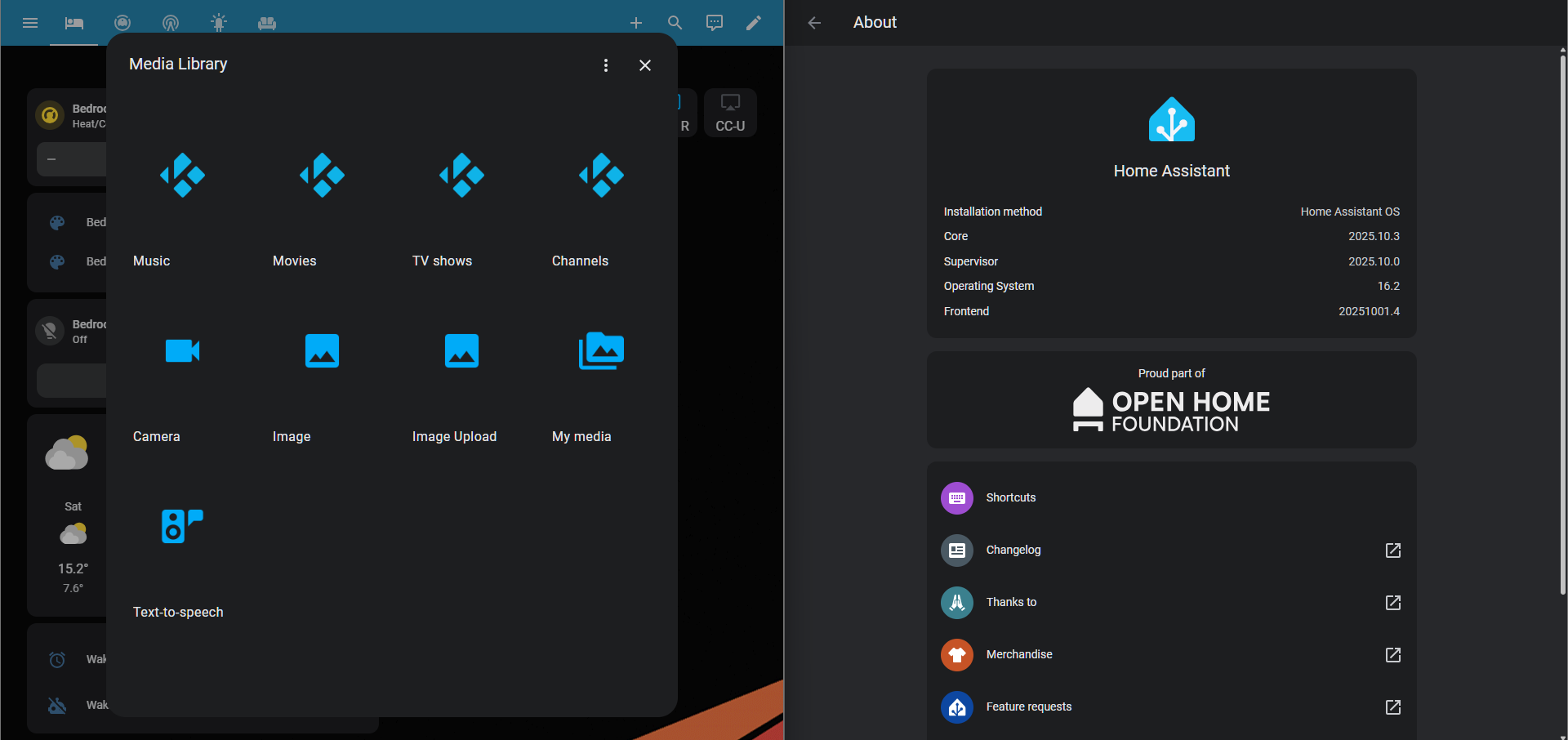

This has been happening since ha core 2025.10 - Now we’re on 2025.10.3 and it has still yet to be fixed which is a bit disappointing.
The fix is a simple one line fix of the kodi browse_media.py file on line 224
Looking at the imports BrowseError is imported from homeassistant.components.media_player not from media_source
So the code incorrectly references media_source.BrowseError when it should be just BrowseError
If anyone wants to DIY the fix here’s how to do it (I’m on HA OS, I recon there are better solutions if you’re running it on full linux with docker):
grab the entire kodi folder from Home Assistant Github
put the folder inside your custom_components folder, that way it will override the default kodi integration
now inside /custom_components/kodi open the file browse_media.py and edit line 224 from with contextlib.suppress(media_source.BrowseError): to with contextlib.suppress(BrowseError): and save it
Also in manifest.json you just have to add a version at the end otherwise HA won’t load the new kodi custom component
