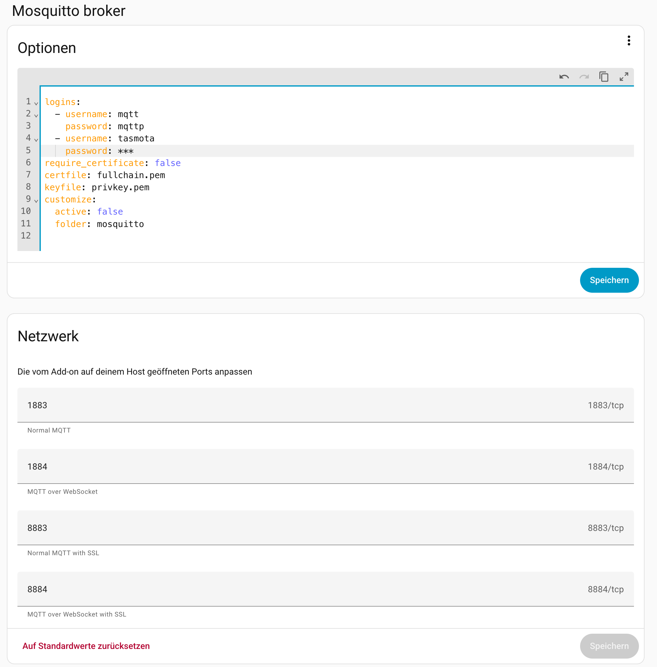

i`m kind of stuck here and hoping for the hivemind.

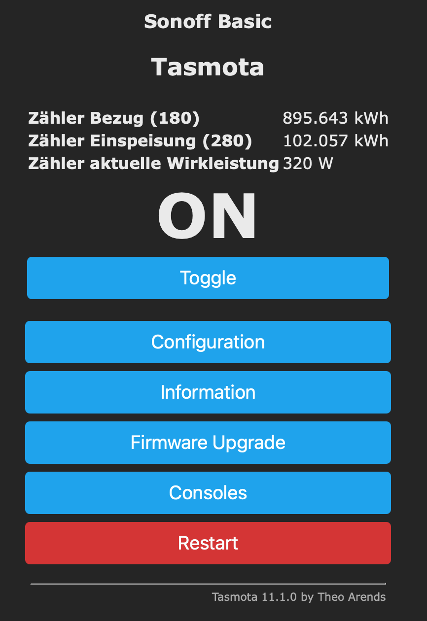

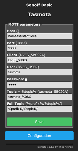

I had this sensor working for a long time flawlessly. Now the IP changed (for both the sensor and HA) and i updated them on the sensor.
I have the tasmota sensor in my wifi - meaning i can access and configure it via it’s web ui.

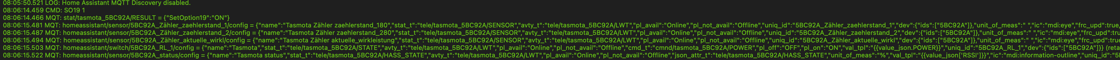

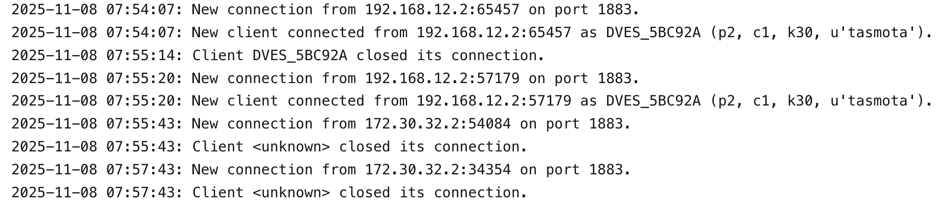

I configured mqqt on HA and seeing in the log, that data is received.

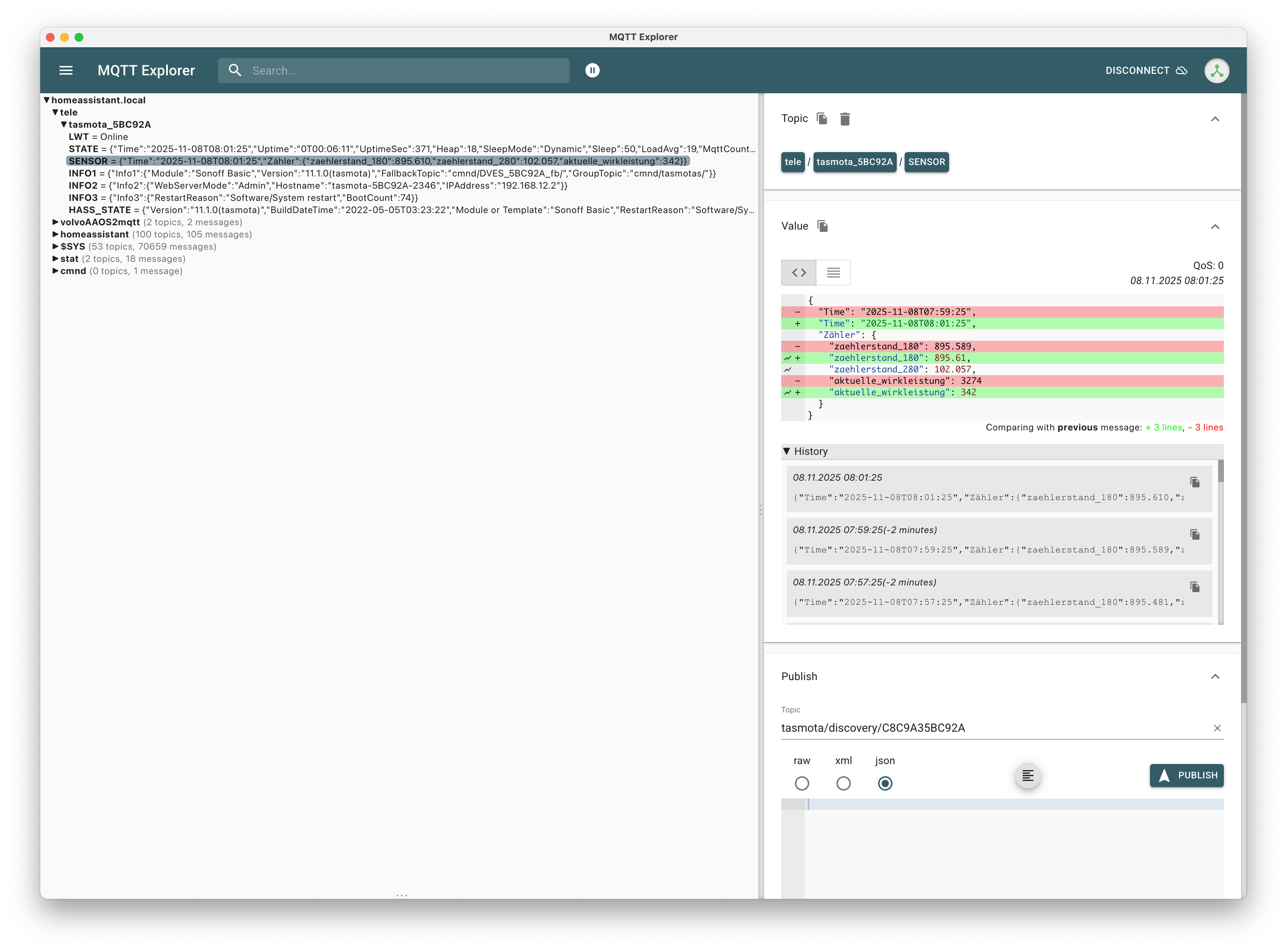

In MQQT Explorer is see the data as well:
But for the life of good, the tasmota integration is not picking it up.
has anybody an idea? i would be very grateful…
Thank you in advance!
are you seeing the discovery topic?
i had a similar issue last week where I forgot to forward the discovery topic between my mqtt brokers. if that is missing, tasmota integration deoes not seem to work. if missing, check the tasmota setoption for home assistant discovery (was it so19?).
Thank you :slight_smile:
Yes, did SO19 0. In the end i had to delete and reinstall the mqqt integration. Somehow ist saved the old IP-Adress of the HA and could not be edited.
After the reinstall everything was smooth sailing and worked as before :slight_smile:
