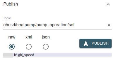

using MQTT Explorer I’m able to write the value using the topic
ebusd/heatpump/pump_operation/set
and in raw mode I simply enter one of the 3 options in the raw section:
How can I do the same via commad_template statement?

Ok, double stupid mistake, first there was a misspelling on the “Modulating” entry then I realized that ebusd integration for this kind of write operations (simple string values converted by ebusd to decimal then hex values) needs to be passed via MQTT without any quoting.
For anyone needing the info this is the correct YAML, tested and working.
