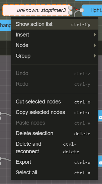

SOLVED: NodeRED, nodes missing and unable to install from palette after. HA Backup Restore
I had to restore HA from a backup today everything seemed to go well. Everything seems to be functional except Node RED.
Of particular note is this from the logs : [19:19:12] WARNING: Failed un-installing conflicting packages
I have tried restoring the back-up again just for the NodeRED Component and that did not work either.
Add-on version: 19.0.2
** You are running the latest version of this add-on.**
** System: Home Assistant OS 15.2 (aarch64 / odroid-n2)**
** Home Assistant Core: 2025.4.3**
** Home Assistant Supervisor: 2025.04.0**
I am getting the following errors:
When I start NodeRED:
When I try to install a missing node from the Manage Palette
2025-04-22T09:33:26.153Z Install : node-red-contrib-tado-client 1.1.1
2025-04-22T09:33:26.610Z npm install --no-audit --no-update-notifier --no-fund --save --save-prefix=~ --omit=dev --engine-strict [email protected]
2025-04-22T09:33:33.792Z [err] npm warn deprecated [email protected]: this package is deprecated please use https://github.com/xmppjs/xmpp.js
2025-04-22T09:33:33.958Z [err] npm warn deprecated [email protected]: this library is no longer supported
2025-04-22T09:33:34.025Z [err] npm warn deprecated [email protected]: Use your platform's native atob() and btoa() methods instead
2025-04-22T09:33:34.089Z [err] npm warn deprecated [email protected]: this package is deprecated please use https://github.com/xmppjs/xmpp.js
2025-04-22T09:33:34.159Z [err] npm warn deprecated [email protected]: use @xmpp/xml package <https://www.npmjs.com/package/@xmpp/xml>
2025-04-22T09:33:34.232Z [err] npm warn deprecated [email protected]: Use your platform's native DOMException instead
2025-04-22T09:33:34.437Z [err] npm warn deprecated [email protected]: Please upgrade to version 7 or higher. Older versions may use Math.random() in certain circumstances, which is known to be problematic. See https://v8.dev/blog/math-random for details.
2025-04-22T09:33:34.588Z [err] npm warn deprecated [email protected]: request has been deprecated, see https://github.com/request/request/issues/3142
2025-04-22T09:33:34.861Z [err] npm warn deprecated [email protected]: this package is deprecated please use https://www.npmjs.com/package/@xmpp/client
2025-04-22T09:33:35.487Z [err] npm warn deprecated [email protected]: 2.x is no longer supported, 3.x published as @viz-js/viz
2025-04-22T09:33:37.049Z [err] npm error code E404
2025-04-22T09:33:37.050Z [err] npm error 404 Not Found - GET https://registry.npmjs.org/node-red-contrib-stoptimer3/-/node-red-contrib-stoptimer3-0.1.2.tgz - Not found
2025-04-22T09:33:37.050Z [err] npm error 404 'node-red-contrib-stoptimer3@https://registry.npmjs.org/node-red-contrib-stoptimer3/-/node-red-contrib-stoptimer3-0.1.2.tgz' is not in this registry.
2025-04-22T09:33:37.050Z [err] npm error 404 Note that you can also install from a
2025-04-22T09:33:37.050Z [err] npm error 404 tarball, folder, http url, or git url.
2025-04-22T09:33:37.054Z [err] npm error A complete log of this run can be found in: /root/.npm/_logs/2025-04-22T09_33_26_836Z-debug-0.log
2025-04-22T09:33:37.109Z rc=1

npm error code E404
npm error 404
npm error 404
npm error A complete log of this run can be found in: /root/.npm/_logs/2025-04-22T09_18_55_187Z-debug-0.log

22 Apr 19:19:19 - [warn] Missing node modules:
22 Apr 19:19:19 - [warn] - node-red-contrib-daylight-rgbw (2.2.1): daylight-rgbw, animate-rgbw
22 Apr 19:19:19 - [warn] - node-red-contrib-tado-client (1.1.1): tado-token, tado-config, tado, tadox-token, tadox-config, tadox
22 Apr 19:19:19 - [warn] - node-red-contrib-stoptimer3 (0.1.2): stoptimer3
22 Apr 19:19:19 - [warn] - node-red-contrib-msg-resend (1.0.0): msg-resend
22 Apr 19:19:19 - [warn] - node-red-contrib-harmony-extra (1.0.1): H command, H press, H release, H hold, H GetActivity, H activity, H observe, H GetActivities, H GetCommands, harmony-server
22 Apr 19:19:19 - [warn] - node-red-contrib-time-of-day (0.0.4): time-of-day
22 Apr 19:19:19 - [warn] - node-red-contrib-castv2 (4.3.0): castv2-connection, castv2-sender
22 Apr 19:19:19 - [warn] - node-red-contrib-jsonfilter (0.1.0): JSONFilter
22 Apr 19:19:19 - [warn] - node-red-contrib-zigbee2mqtt (2.7.5): zigbee2mqtt-in, zigbee2mqtt-get, zigbee2mqtt-out, zigbee2mqtt-bridge, zigbee2mqtt-server
22 Apr 19:19:19 - [warn] - node-red-contrib-zigbee2mqtt-devices (0.20.0): bridge-log, zigbee2mqtt-bridge-config, zigbee2mqtt-device-config, eurotronic-spirit, hue-dimmer-switch, ikea-dimmer, ikea-remote, ikea-dimmer-v2, ikea-styrbar, scenic-foh-switch, sonoff-button, tasmota, tint-remote, generic-lamp, send-messages, button-switch, device-status, get-lamp-state, shelly-config, shelly-25, ota-update, override-state, override-brightness, override-temperature, override-color, override-action, scene-in, scene-selector, contact-sensor, occupancy-sensor, climate-sensor
22 Apr 19:19:19 - [warn] - @jorgelserve/node-red-contrib-ssh-v3 (1.0.5): ssh-v3
22 Apr 19:19:19 - [warn] - node-red-contrib-telnet-client (1.0.4): telnet-connection, telnet-read, telnet-send, telnet-request, telnet-echo
22 Apr 19:19:19 - [warn] - node-red-contrib-dsm (0.14.1): dsm
22 Apr 19:19:19 - [warn] - node-red-contrib-light-transition (1.8.1): light-transition
22 Apr 19:19:19 - [warn] - thingzi-logic-climate (1.1.1): thingzi-climate
22 Apr 19:19:19 - [warn] - thingzi-logic-timers (1.4.6): thingzi-timer, thingzi-time-check, thingzi-schedule, thingzi-activity
22 Apr 19:19:19 - [warn] - node-red-contrib-persist (1.1.1): persist-store, persist in, persist out
22 Apr 19:19:19 - [warn] - @waldbaer/node-red-persistent-values (1.6.1): persistent values config, persistent value
22 Apr 19:19:19 - [warn] - @bitpoolos/edge-modbus (1.5.9): bp-device, bp-reader, bp-decoder, bp-display, bp-modbus-io-config, bp-modbus-client
22 Apr 19:19:19 - [warn] - node-red-contrib-string-filter (0.0.1): string-filter
22 Apr 19:19:19 - [warn] - node-red-contrib-blockly (2.4.1): Blockly, blockly-config
22 Apr 19:19:19 - [warn] - node-red-filter-filename (0.0.2): filter-filename
22 Apr 19:19:19 - [warn] - smart-nodes (0.4.21): smart_light-control, smart_scene-control, smart_shutter-control, smart_shutter-complex-control, smart_long-press-control, smart_multi-press-control, smart_logic, smart_forwarder, smart_compare, smart_hysteresis, smart_statistic, smart_counter, smart_scheduler, smart_delay, smart_central-control, smart_mixing-valve, smart_heating-curve, smart_text-exec
22 Apr 19:19:19 - [warn] - node-red-contrib-vib-smart-scheduler (0.1.55): smart-scheduler, smart-scheduler-settings
22 Apr 19:19:19 - [info] Removing modules from config
22 Apr 19:19:19 - [info] Settings file : /etc/node-red/config.js
22 Apr 19:19:19 - [info] Context store : 'default' [module=memory]
22 Apr 19:19:19 - [info] User directory : /config/
22 Apr 19:19:19 - [warn] Projects disabled : editorTheme.projects.enabled=false
22 Apr 19:19:19 - [info] Flows file : /config/flows.json
22 Apr 19:19:19 - [info] Server now running at http://127.0.0.1:46836/
22 Apr 19:19:19 - [info] Waiting for missing types to be registered:
22 Apr 19:19:19 - [info] - harmony-server
22 Apr 19:19:19 - [info] - zigbee2mqtt-bridge-config
22 Apr 19:19:19 - [info] - tado-config
22 Apr 19:19:19 - [info] - stoptimer3
22 Apr 19:19:19 - [info] - msg-resend
22 Apr 19:19:19 - [info] - time-of-day
22 Apr 19:19:19 - [info] - ssh-v3
22 Apr 19:19:19 - [info] - light-transition
22 Apr 19:19:19 - [info] - tado-token
22 Apr 19:19:19 - [info] - H press
22 Apr 19:19:19 - [info] - H release
22 Apr 19:19:19 - [info] - H activity
22 Apr 19:19:19 - [info] - H command
22 Apr 19:19:19 - [info] - filter-filename

All the other nodes have loaded now, I am working through my flows to replace all the timers I had in place.
  1. Check previous config for each timer Right click on each unknown:stoptimer3, Select Export and check the duration.
  1. Replace each node with stoptimer2 nodes
  2. In the end I replaced all Stoptimer2 nodes with built in Delay nodes to hopefully prevent this happening again
