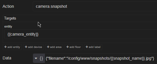

When triggered, I capture the camera image and save it to a folder…
I verified that the correct image is saved and it is correctly saved every time…

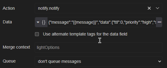

The notification is sent…
The data field expanded looks like this…
    "message": "{{message}}",
    "data": {
        "ttl": 0,
        "priority": "high",
        "sticky": "true",
        "car_ui": "true",
        "color": "red",
        "image": "/local/snapshots/{{snapshot_name}}.jpg",
        "timeout": "{{timeout}}",
        "actions": [
                "action": "URI",
                "title": "OPEN CAMERA",
                "uri": "/google-pixel/cameras"
Note that I use “/local/snapshots/” for the notify path because the notify.notify service did not work with “/config/www/snapshots/” but essentially it’s the same thing.
If anyone has experienced this issue or has notification working I would love to hear from you.

Yes. snapshot_name is also used for the saving so it is correct.
This service does not always work the way you would expect. It is recommended to always use the device’s actual notification entity.
I also tried specifying my phone “notify.pixel_6a” and got the same result.
I do get an image displayed but it’s an image from a few days ago.
