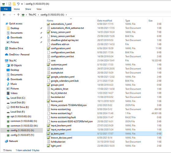

I have the same issue with 403 forbidden error, without any access remotly or with local ip. Yes I have Samba configured and SSH also. How Can i access and check the ip_bans.yaml
Thanks
I would use Samba, and then Notepad or Notepad++
many Thanks. i access to my files and clear ip_bans.yaml. but it seems that it need a repair of home assistant, i wonder if can be possible without re-installing all.
