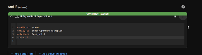

Well, I don’t know what happend, but now it is working:
With this YAML:
condition: state
entity_id: sensor.purmerend_papier
attribute: Days_until
state: 6
