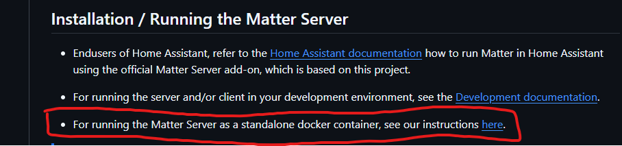

Well, this doc recommends to use Home Assistant OS (as AI told me).
