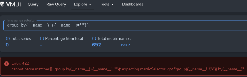

I tried the test in the (VictoriaMetrics: Long-Term Storage of Home Assistant Data) integration shown here:
group by(__name__) ({__name__!=""})
“> You should see a list of metrics names, including, for example, weather.forecast_home_temperature.”
I get an error:
I mean, the query seems fine: get the names where the name is not null.

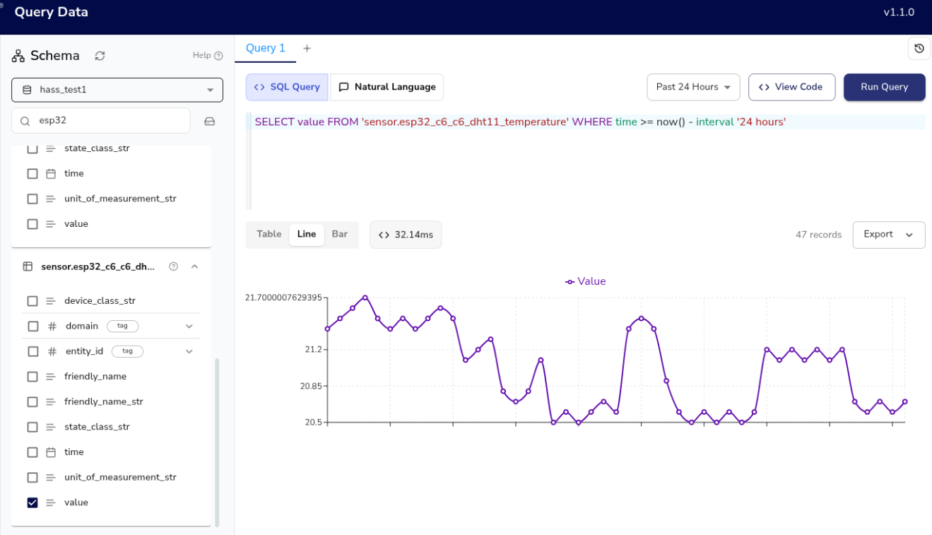

Here’s the result of a query in Influxdb for a known entity (ESPhome temperature sensor value:
Yep, that seems perfectly OK.

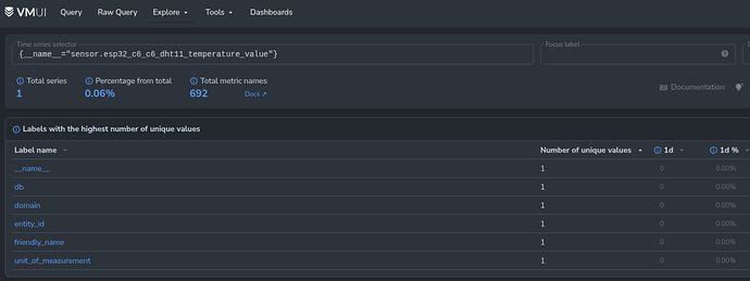

Here’s my attempt to do the same in VM:
Most of the entities are there but not “value” and I am unable to see any measurements whatever I do.

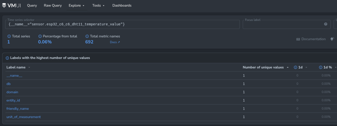

I completely removed the containers, the image and the permanent storage volumes using a slightly modified value for the latter.
Spinning-up victoria-metrics and restarting HA (with tge same configuration given above) seems to have solved the issue.
All the entities are there as is the associated data (values).
