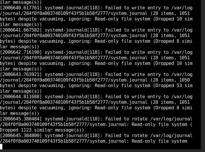

In the Web UI of my HA instance I see that a HA supervisor update from version 2026.07.3 to 2026.07.5 is running for a week now and does not complete. I cannot access the terminal (in the WebUI). It shows only “coudn’t create directory /tmp/tmux-0 (Read-only filesystem).”
In the console I see messages like the ones on attached screenshot.
To me the only option seems to be to reset the instance. Do you have any recommondation what I can try instead and what might haved caused this issue?

I would ReBoot instead of just restart … Actually that’s what latest Supervisor " Request/Requires "
The reboot helped. HA is up and running again.
I didn’t find any root cause for the issue. I think it’s time to put some effort to improve my monitoring.
The Root cause was that Supervisor requested a reboot, you just might not have seen it, Yes checking logs regularly i.e after major Releases etc, is a good way to start “maintenance monitoring”
