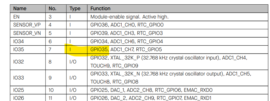

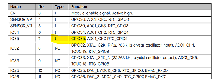

Whilst I can use esp32dev successfully, GPIO35 is flagged as IN only and not IO. However, the spec for ESP32-WROOM-32U shows pin 35 should be IO.
Q: Is there a better board I should select in the YAML, because I can’t find a match?

WROOM-32U datasheet gives:
And your board esp32dev is correct for your MCU.

I have bee looking at both of those and there is no obvious match. I tried “MH ET LIVE ESP32DevKIT” board: mhetesp32devkit, but it still shows an error on GPIO35.
The work-around, for me, has been to use some other GPIO pin.
Yes, thank you.
I should have gone to GitHub as a first port of call.
