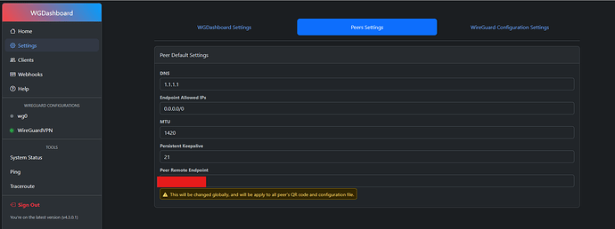

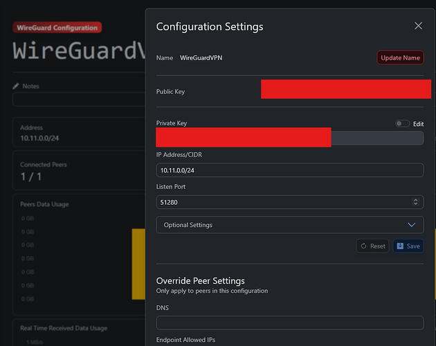

I’ve set it up through WgDashboard as followed:
Overall peer settings:
VPN Configuration:

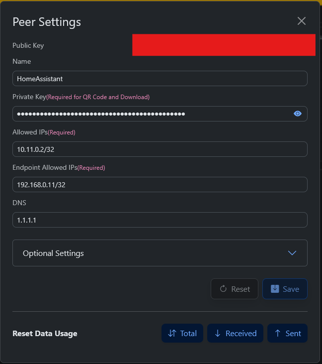

Peer settings, where the endpoint ip the HA ip address is:
After this I scan the QR code which is generated with my phone.

Oof ok, so try to allow 0.0.0.0 as endpoint allowed IP’s. Also you are testing from the same lan to connect to the VPN? Cause if you do not have an external IP forwarded from your router (external side) to the IP address of the VM, you are basically going to a public IP range on the internet to try to connect to 10.11.0.2.

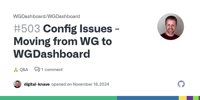

Found here info:
Adding the following made it work instantly :sunglasses:
PostUp:
iptables -A FORWARD -i NAMEOFYOURCONFIG -j ACCEPT; iptables -A FORWARD -o NAMEOFYOURCONFIG -j ACCEPT; iptables -t nat -A POSTROUTING -o eth0 -j MASQUERADE;
PostDown:
iptables -D FORWARD -i NAMEOFYOURCONFIG -j ACCEPT; iptables -D FORWARD -o NAMEOFYOURCONFIG -j ACCEPT; iptables -t nat -D POSTROUTING -o eth0 -j MASQUERADE;
