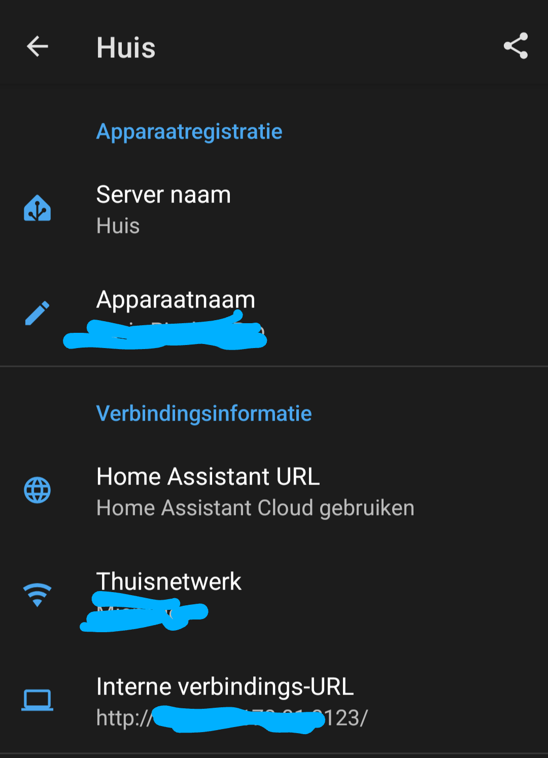

I’ve added the android companion app through play store on a new device (tablet) after running the companion app on different mobile devices without problems using home assistant cloud connection.
After this worked initially fine for a couple of minutes suddenly ALL companions apps stopped working through home assistant cloud connection.
I’ve fixed this by going to settings → companion app → selecting my home under settings & devices and setting up my home network and internal connection URL. Before, this was empty and worked fine.
I’ve ran into this a week earlier and at that time couldn’t find the fix and used a backup to get it back to working normally.

I have a simple setup with home assistant running on an odroidN2+ which is on the same network as all my other devices. I have a nabu casa cloud subscription. I do also use pihole but stopped this to test it after getting the connection error without resolving the issue.
Any thoughts on why this happens?
Also, since this problem i also cannot access home assistant from outside my network.
I get: error 403: forbidden. I checked again if connecting through HA Cloud service was enabled and it is.
Check if you have ip_ban_enabled & login_attempts_threshold in your configuration.yaml file. If you do, chances are your IP is listed in a separate ip_bans.yaml file. Read here on how to deal with it
Great, many thanks!! This was some old yaml in there from the time I had setup external connection through nginx etc. Removed it to remove my problems.
