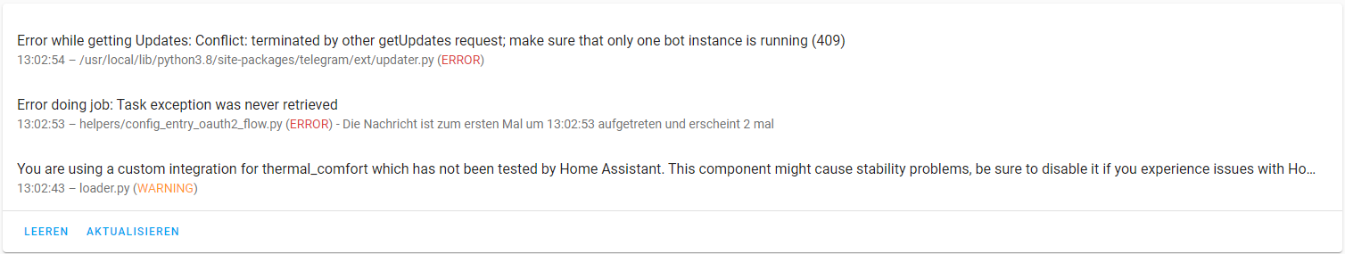

in the Core Logs, there are a couple of errors, but they are related to the telegram integration, which I doubt have yn connection to this issue

2020-12-24 13:02:40 WARNING (MainThread) [homeassistant.loader] You are using a custom integration for hacs which has not been tested by Home Assistant. This component might cause stability problems, be sure to disable it if you experience issues with Home Assistant.
2020-12-24 13:02:43 WARNING (MainThread) [homeassistant.loader] You are using a custom integration for thermal_comfort which has not been tested by Home Assistant. This component might cause stability problems, be sure to disable it if you experience issues with Home Assistant.
2020-12-24 13:02:53 ERROR (MainThread) [homeassistant] Error doing job: Task exception was never retrieved
File “/usr/src/homeassistant/homeassistant/data_entry_flow.py”, line 130, in async_init
result = await self._async_handle_step(
File “/usr/src/homeassistant/homeassistant/data_entry_flow.py”, line 213, in _async_handle_step
result: Dict = await getattr(flow, method)(user_input)
File “/usr/src/homeassistant/homeassistant/helpers/config_entry_oauth2_flow.py”, line 318, in async_step_discovery
return await self.async_step_pick_implementation()
File “/usr/src/homeassistant/homeassistant/helpers/config_entry_oauth2_flow.py”, line 243, in async_step_pick_implementation
return await self.async_step_auth()
File “/usr/src/homeassistant/homeassistant/helpers/config_entry_oauth2_flow.py”, line 267, in async_step_auth
url = await self.flow_impl.async_generate_authorize_url(self.flow_id)
File “/usr/src/homeassistant/homeassistant/helpers/config_entry_oauth2_flow.py”, line 147, in async_generate_authorize_url
redirect_uri = self.redirect_uri
File “/usr/src/homeassistant/homeassistant/helpers/config_entry_oauth2_flow.py”, line 131, in redirect_uri
raise RuntimeError(“No current request in context”)
RuntimeError: No current request in context
2020-12-24 13:02:54 ERROR (updater) [telegram.ext.updater] Error while getting Updates: Conflict: terminated by other getUpdates request; make sure that only one bot instance is running (409)
2020-12-24 13:04:01 ERROR (updater) [telegram.ext.updater] Error while getting Updates: Conflict: terminated by other getUpdates request; make sure that only one bot instance is running (409)
no idea what all this means xD
Also, I did try to disable these addons and restart HA - no change
The errors are not related to this sensor.
hmm thanks anyway ^^
