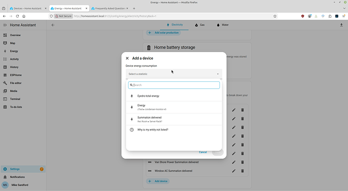

Now I'm trying to add them all to my energy dashboard to get those nice graphs I had a week ago and only about 1/2 of them are able to be added. I followed the link from the "add new device" screen on the energy dashboard here: Frequently Asked Questions about home energy management - Home Assistant but that doesn't really help me figure out why SOME plugs work just fine and OTHERS aren't available at all.
They all seem to have both Power and Summation delivered which seems to be the things in that FAQ that are required. I have tried pressing the "reconfigure" button on the device details page, and I've also tried removing a device entirely and re-adding it. In both cases it seems to show up fine with the correct details on the details page. But again when going to try and add it on the energy page, it's just not available anymore.

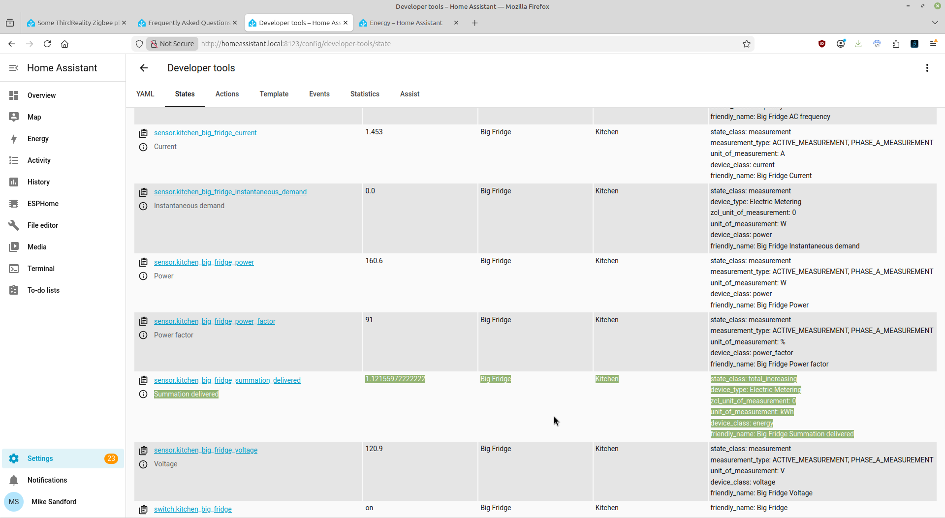

Those things are not what is mentioned as required in the FAQ. The important thing is that your energy entities for those plugs contain device_class, state_class & unit_of_measurement.
Go to the Dev Tools page & compare the attributes for the energy entity of a visible device vs an invisible device. Most likely the invisible devices are missing one or more of the above attributes.

Doesn't work:

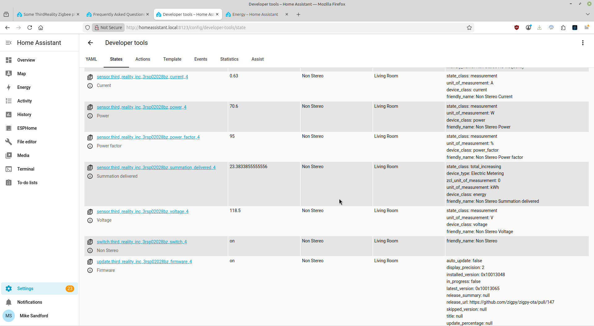

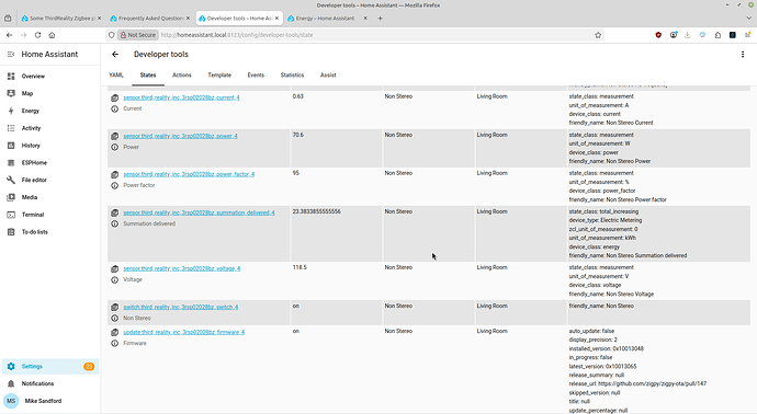

I'm looking at this one and it sure seems like it's got all the data required as per the FAQ
device_class: energy
state_class: total_increasing
unit_of_measurement: kWh

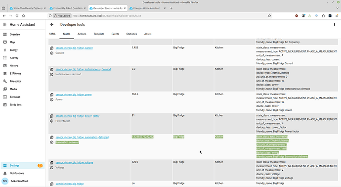

Does work:
I'm struggling to tell the difference between the two. Very similar if not identical energy and power sections.
Maybe I'm missing something? I really can't tell what's going on here.

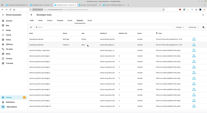

Also you can check developer-tools/statistics, and check for any statistics issues.
That was it! There were 8+ statistics issues that I was able to press the "fix" button on and they're showing up in the energy dashboard now.
Thanks very much for the help!
