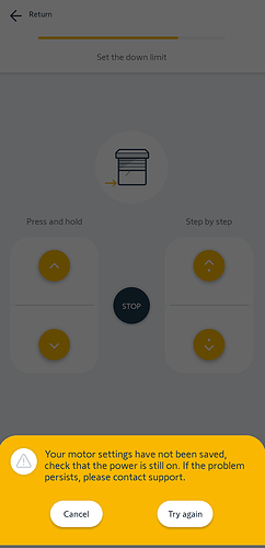

The Tahoma PRO app is available on the NA Play Store and is usable. However, it fails me when I am trying to set the β€œlower endpoint”:
No idea why. My suspicion is that even if this succeeds, I won’t be able to pair it, because setting it into pairing mode results in some sort of reset. I was able to pair it before, but got the same errors that it won’t move up or down.
Any suggestions? Ridiculous that Somfy makes it so difficult to use their goddamn product. Are there any other good ZigBee shades that can be trusted?
