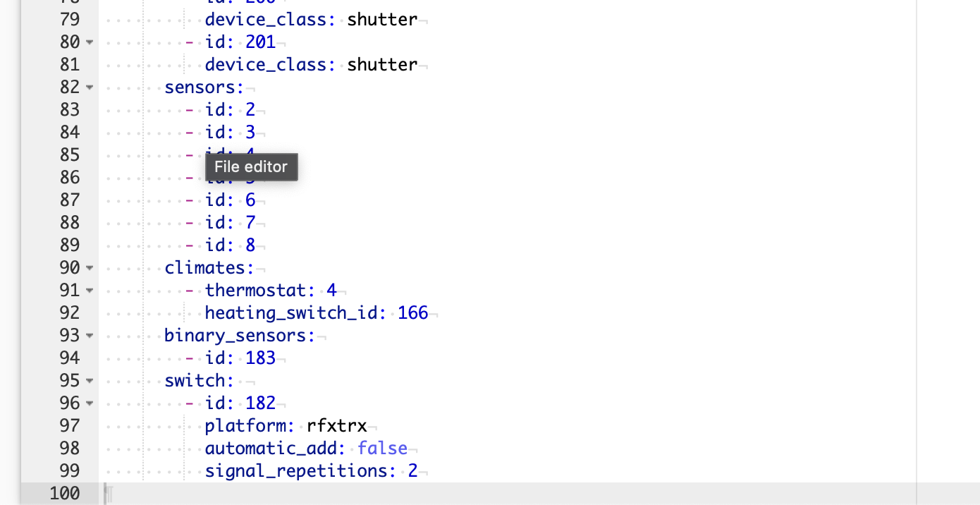

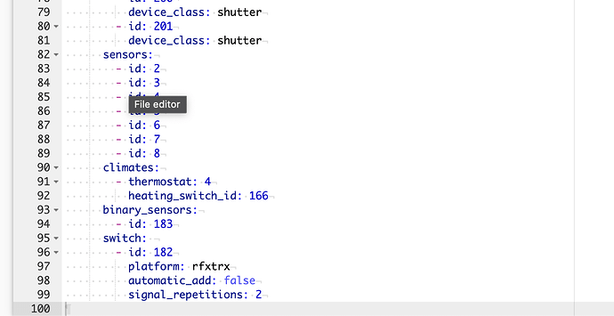

Hi Guys, I have a similar issue with same sensor from Somfy. Can you please help me to implement it to my yaml?
I had a look at my setup and it turns out I no longer have entries for my Somfy blinds and sun/wind detector in the config.yaml. Everything is handled via the rfxcom integration. Did you add that integration? Have look at the documentation for the integration at RFXCOM RFXtrx - Home Assistant. The integration should automatically detect the devices.
I have a device connected to my smart home TapHome. I will try to us the RFXCOM.
EDIT: It does not work. No serial connection or network. :confused:
EDIT2: I have same issue with comfy blinds. Does not work too.
