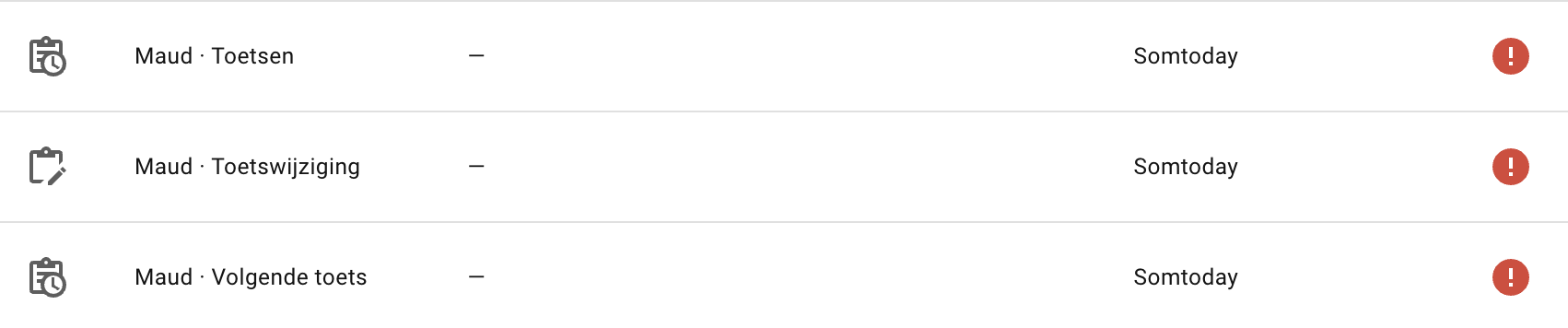

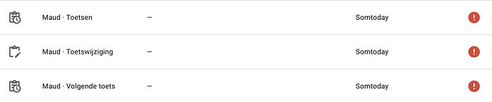

I tried the beta, but i don’t get any tasks. It also says ‘Unavailable’ in the entities-screen.
Did you enable the option in the integration settings?
Yes, i created a todo-list first and then changed the settings and pointed to the todo-list.

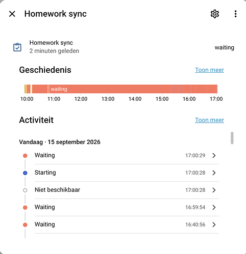

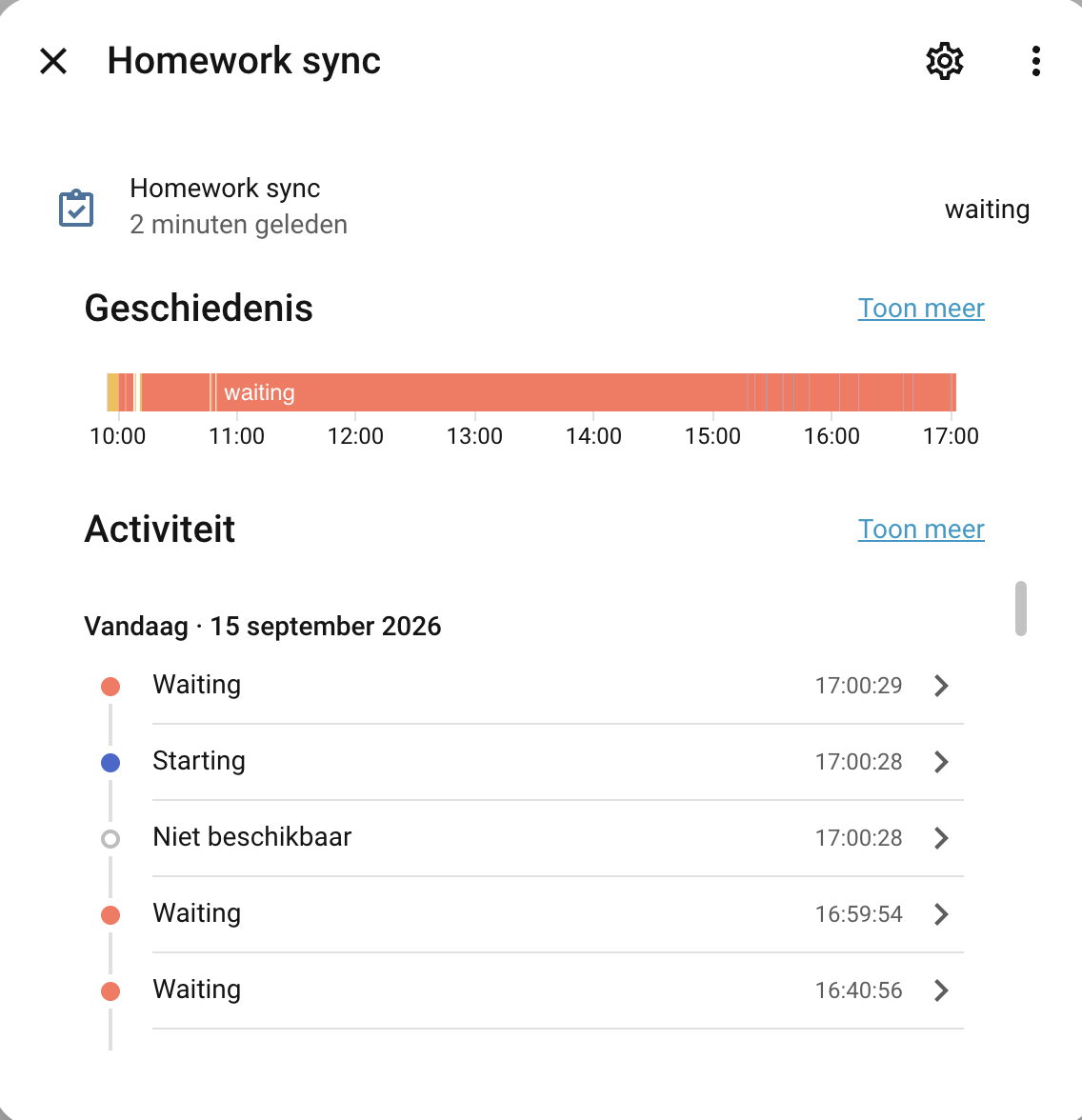

I don’t see any log-values (with debug-loggin on), only:
2026-09-15 17:00:28.706 DEBUG (MainThread) [custom_components.somtoday.coordinator] Finished fetching somtoday data in 0.504 seconds (success: True)
Hi @ErikWie, thanks! The success: True message doesn’t necessarily mean the homework requests succeeded.
Could you open Tools > States, find the Homework sync sensor and copy its attributes, especially reasons? Your screenshot shows its history, but the attributes should tell us which step is failing.
