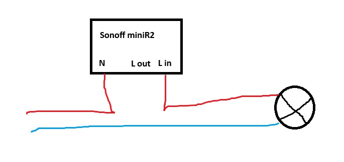

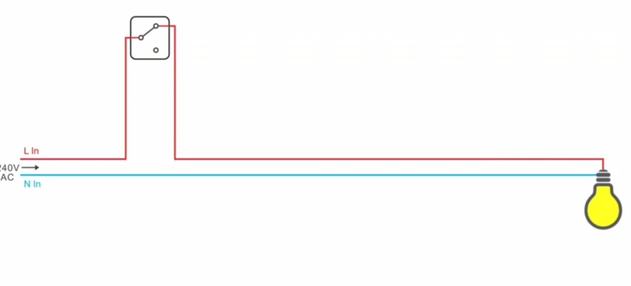

here is a pic I found which is the current situation.in that image … where the switch is shown … I wired the Sonoff in. One end to N, the other to L1 In.
Yes, that’s normal wiring scheme.

Like you see from the image, if lamp is not connected to L, it can pass N to Sonoff through the lamp.

What am I missing? I had the swtich in the image replaced with the Sonoff.
The L Out remained unused and the lamp was off.
Your N and L are inverted.
As far as you keep the lamp in place and don’t use it you are good to go.

What you mean “inverted”? The lamp did not turn on btw.
Edit: you mean the old switch is just switching the neutral side?
Yeah I got a couple of those and a few alternatives to play around with.
The line on the left going to Sonoff is Neutral??
It is “the wire” that´s in my wall. I have a simple On/Off Switch in the wall. I took the two wires going in the switch (one is blue, the other is brown) and connected them to the Sonoff.
