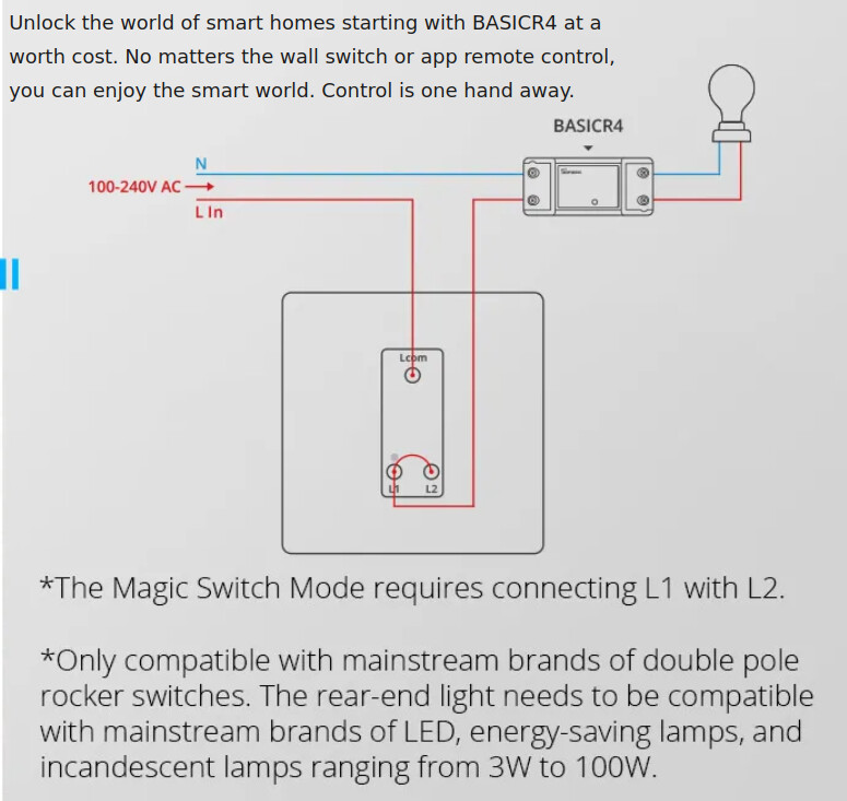

I wasn’t sure what Magic Switch Mode was, but I found this image and it explains it to me:

I think any capacitor that will smooth the power enough will also kill the magic switch fuctionality which relies on a 4ms-5ms cut from switch in my case.
