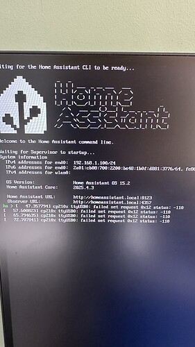

  • Logs show it being recognized and attached to ttyUSB0, but shortly after, I see:
[58190.645259] cp210x 1-11:1.0: cp210x converter detected
[58190.646967] usb 1-11: cp210x converter now attached to ttyUSB0
[58191.035936] cp210x ttyUSB0: cp210x converter now disconnected from ttyUSB0
[58191.036050] cp210x 1-11:1.0: device disconnected

  5. Checked dmesg logs – device is recognized, but then disconnects with failed set request 0x12 status: -19.

I’ve been having this issue for at least the last month. I’ve tried new VMs, even a new proxmox node, and a different one of the same dongle. Same issue, I had no issues for the last couple of years on it.
Your core version is quite old and it may be worth updating first. 2025.6.0 is the latest.
