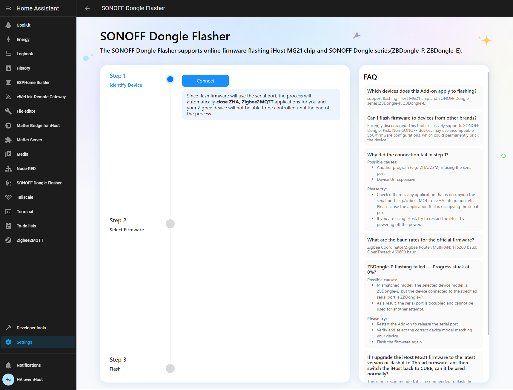

Hi everyone, we know a lot of people are using SONOFF ZBDongle-E and ZBDongle-P, but having difficulties managing its firmware.
SONOFF has developed a Web tool called SONOFF Dongle Flasher which makes it very easy to manage ZBDongle’s firmware. But it has one drawback: it requires users to has physical access to the ZBDongle (unplug the ZBDongle from HA, and then plug it to a PC/MAC), which means users can not do the flashing remotely.
Now the iHost Open Source Project has released SONOFF Dongle Flasher add-on v1.1.0 which is basically an HA add-on version of the Web tool SONOFF Dongle Flasher, but it allows you to manage ZBDongle’s firmware remotely.
The v1.1.0 add-on is available in armv7, aarch64, amd64 architecture, so you can use it not only on iHost, but also on other HAOS installations.
It supports flashing Zigbee Coordinator, Thead, Multiprotocol, 3rd-party firmware onto SONOFF ZBDongle-E (Silicon Labs MG21 chip), and Zigbee Coordinator, 3rd-party firmware on to SONOFF ZBDongle-P (TI CC2652p chip).
For those who are interested, please give it a try and let us know if it works for you.

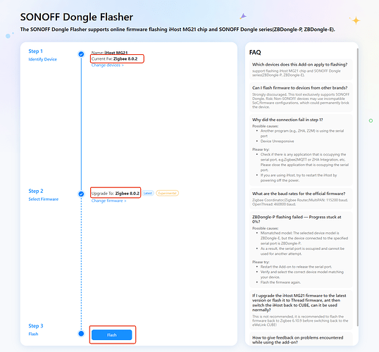

I installed the addon, ran it and it shows my firmware is current. Then I stopped the add on and turned off start on boot. If i then go to integrations ZHA is gone and shows under disabled.
Tried the same steps a second time with the same results, so not something I inadvertently did wrong.

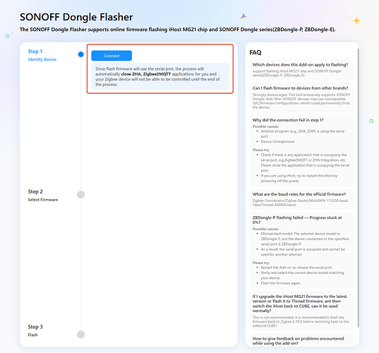

Yes. this is exactly the case if you click Connect button to check the firmware, but don’t go through the whole process (click Flash button).
There is a note saying Since flash firmware will use the serial port, the process will automatically close ZHA, Zigbee2MQTT applications for you and your Zigbee device will not be able to be controlled until the end of the process. below the Connect button.

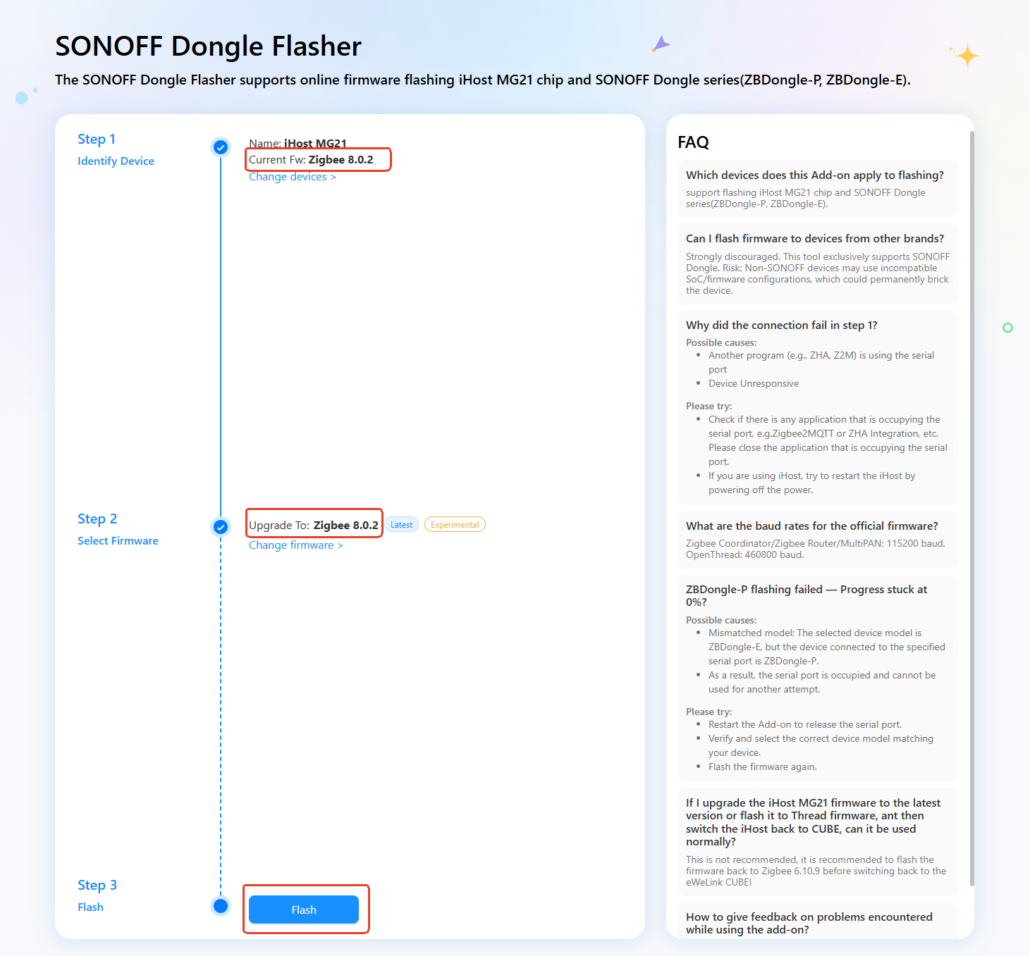

I’ve done that and it didn’t auto find my device so I added it manually and it showed up and said update available so I started the update but it’s been on 0% for a while
please tell me I’ve not bricked it
