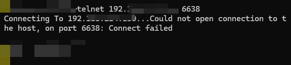

  1. And I cannot establish a connection to it when I run telnet x.x.x.x 6638 on my Windows PC
  2. Prime suspect is the dongle’s port 6638 correct?

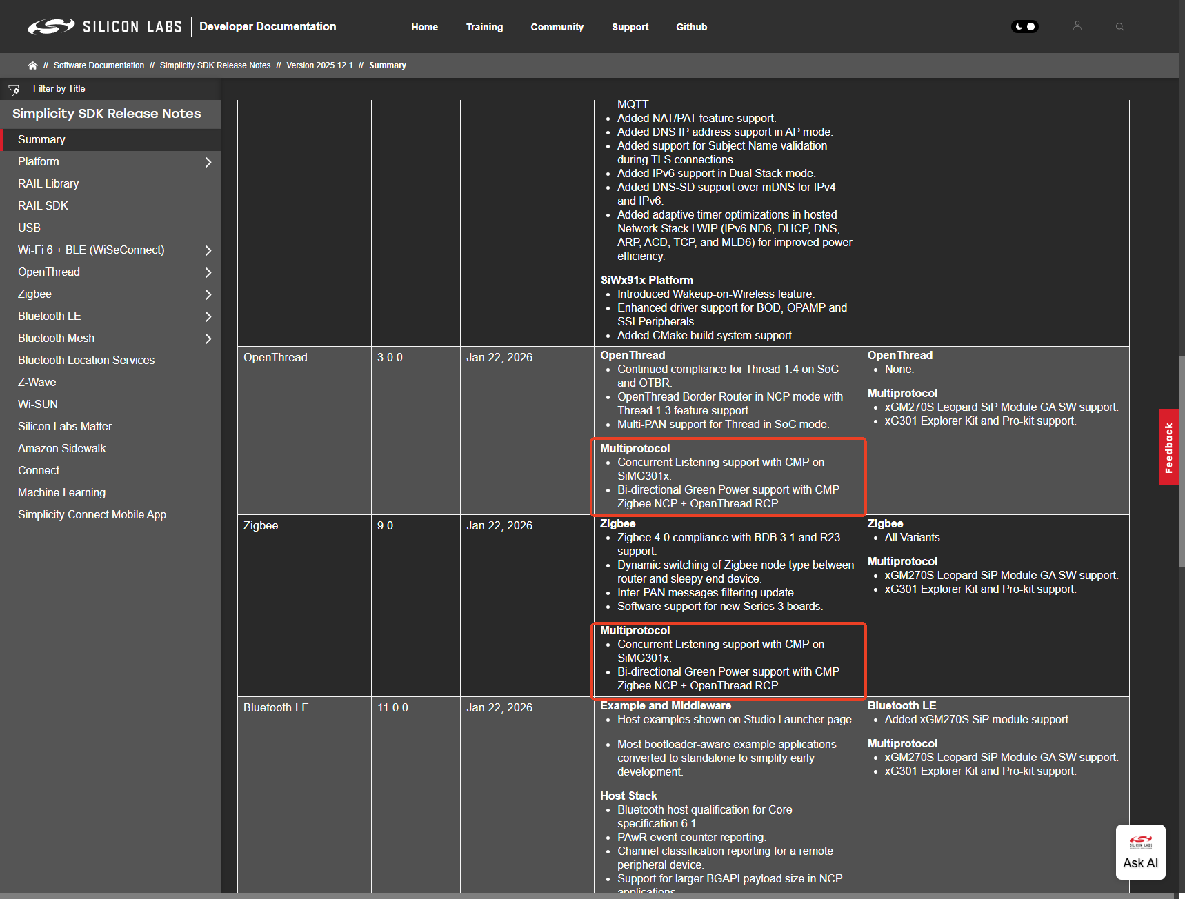

Hi, regarding HA’s drop of the support for Multiprotocol, we have replied many times, here are the main points:
  1. Multiprotocol is Silicon Lab’s technology, not HA’s. HA’s now-discontinued Multiprotocol App is based on Silicon Labs’ SDK.
  2. Silicon Labs is continuing developing its Multiprotocol technology, also with the feedback and contribution from its buisness partners, like Aqara and SONOFF. Please refer to Simplicity SDK Version 2025.12.1 - Release Notes (Feb 5, 2026) | Summary | Simplicity SDK Release Notes | v2025.12.1 | Silicon Labs for the latest update on Multiprotocol.
  3. Many manufacturers have launched Zigbee/Thread products based on Silicon Labs’ Multiprotocol technology. They all think it’s stable and ready for commercial use.
  4. HA surely has its freedom and reason to abandon its own Multiprotocol app. I don’t think I should comment on it.

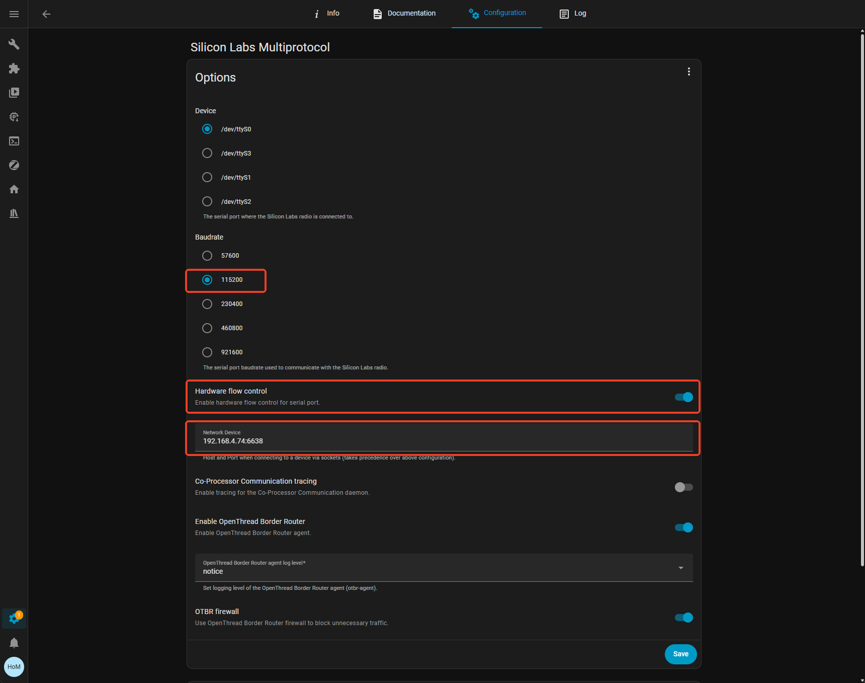

When Dongle-M is in MultiPAN mode, you will need to run the Silicon Labs’ Multiprotocol add-on from hassio-ihost-addon/hassio-ihost-silabs-multiprotocol at master · iHost-Open-Source-Project/hassio-ihost-addon · GitHub. The Configuration of the Multiprotocol app is like the following:
  • Device: choose Dongle-M if it’s connected through USB, or any device if Dongle-M is used as a Network Device.
  • Baudrate: 115200
  • Hardware flow control: false
  • Network Device: The IP and port of Dongle-M

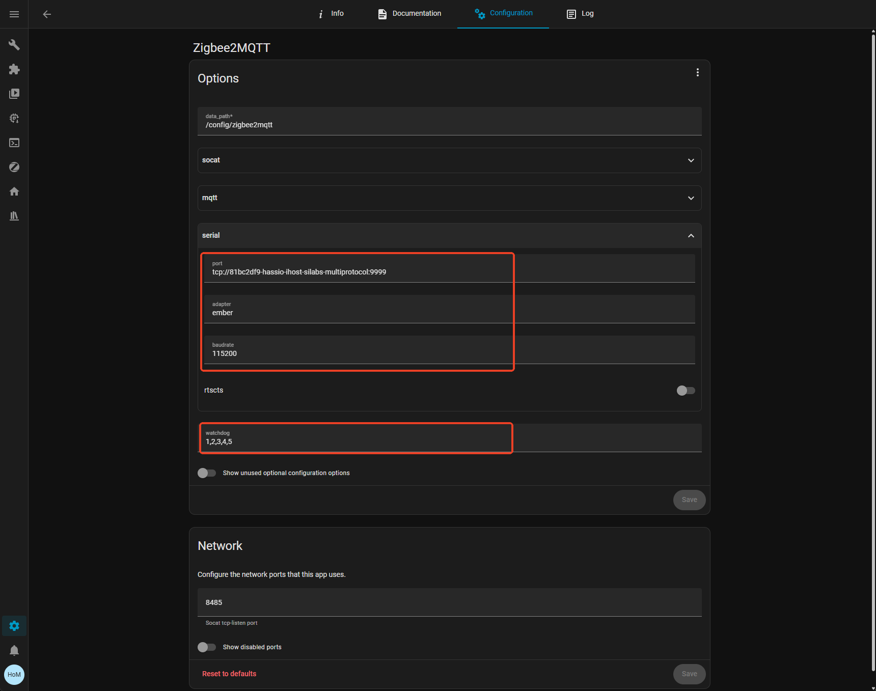

And the Zigbee2MQTT’s Configuration should be like following:

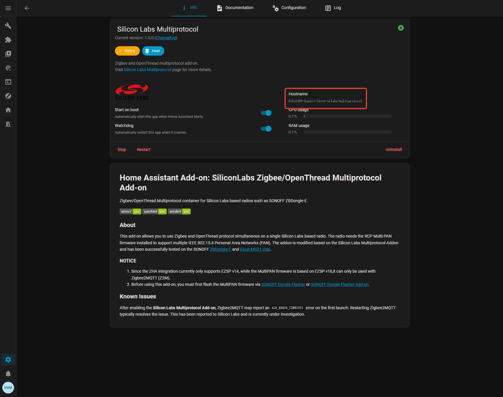

  • port: the hostname and port provided by Multiprotocol app. You can find the Hostname on HA -> Settings -> Apps -> Silicon Labs Multiprotocol -> Info page. The port is always 9999.
  • adapter: ember
  • baudrate: 115200
Note: you should delete all old Zigbee2MQTT configuration and database files (basically all files under /homeassistant/zigbee2mqtt) if you want to migrate from Dongle-M’s Zigbee Coordinator to Multiprotocol app’s Zigbee Coordinator.

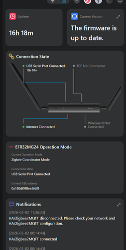

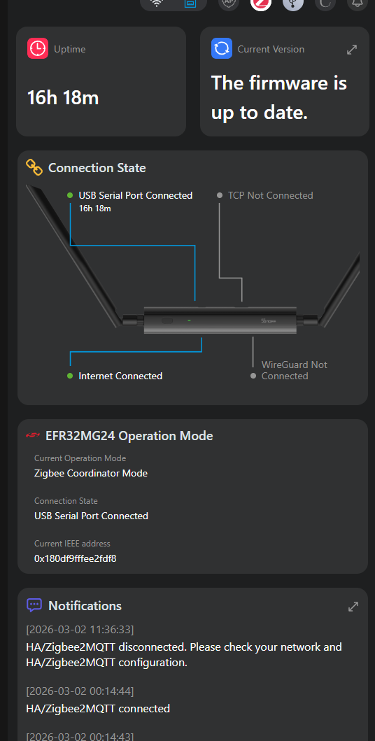

Stability issues in Zigbee Coordinator mode
  1. After 10 hours, the dongle disconnects
  2. At around 16 hours, I still could not connect to port 6638
  3. Reboot Dongle-M fixed the problem

By the way, you won’t be able to telnet Dongle-M when Dongle-M is connected to ZHA/Z2M. To save resources, Dongle-M only allows 1 active TCP connection on port 6638.
Yes, but the logs show 11:36 disconnected, then I try to telnet at 15:30, cannot open connection.

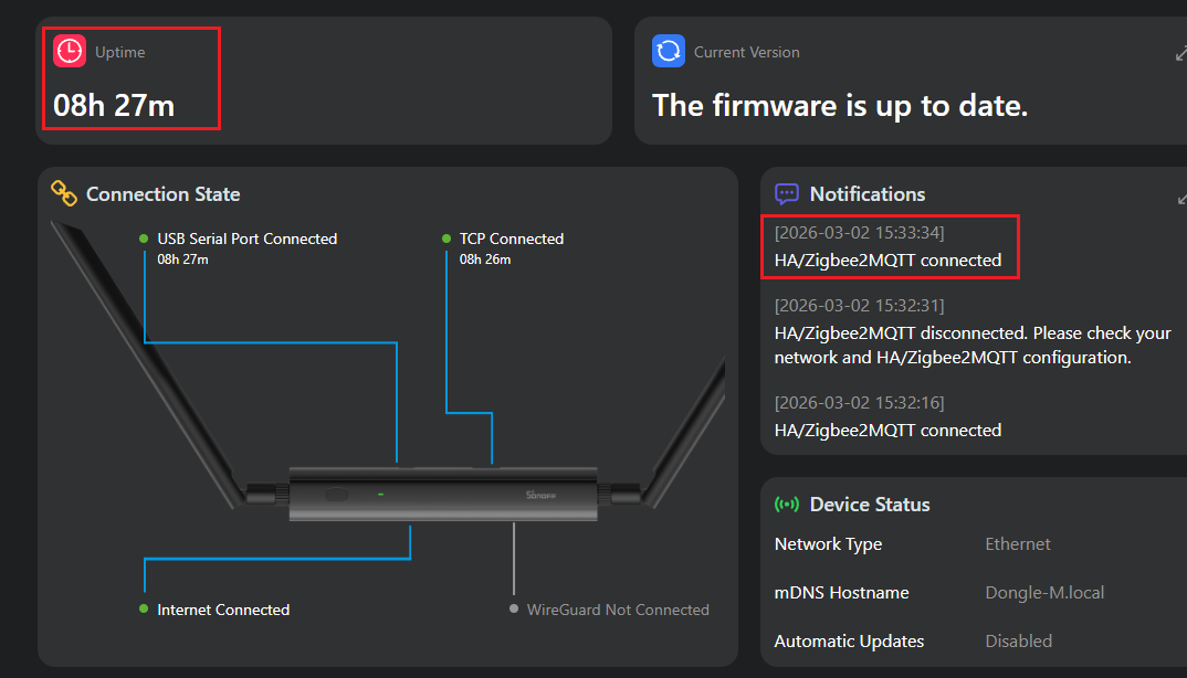

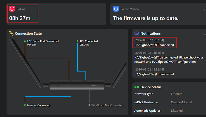

  1. There is no firmware update activity, and the auto update is off
  2. Uptime now is 8 hours and TCP is also connected for about the same time since 15:33 (8 hours ago)
  3. If there is a network problem and zigbee2mqtt gets disconnected from the dongle, am I correct to say that I would be able to connect to the dongle’s port 6638 from any other IP address?
