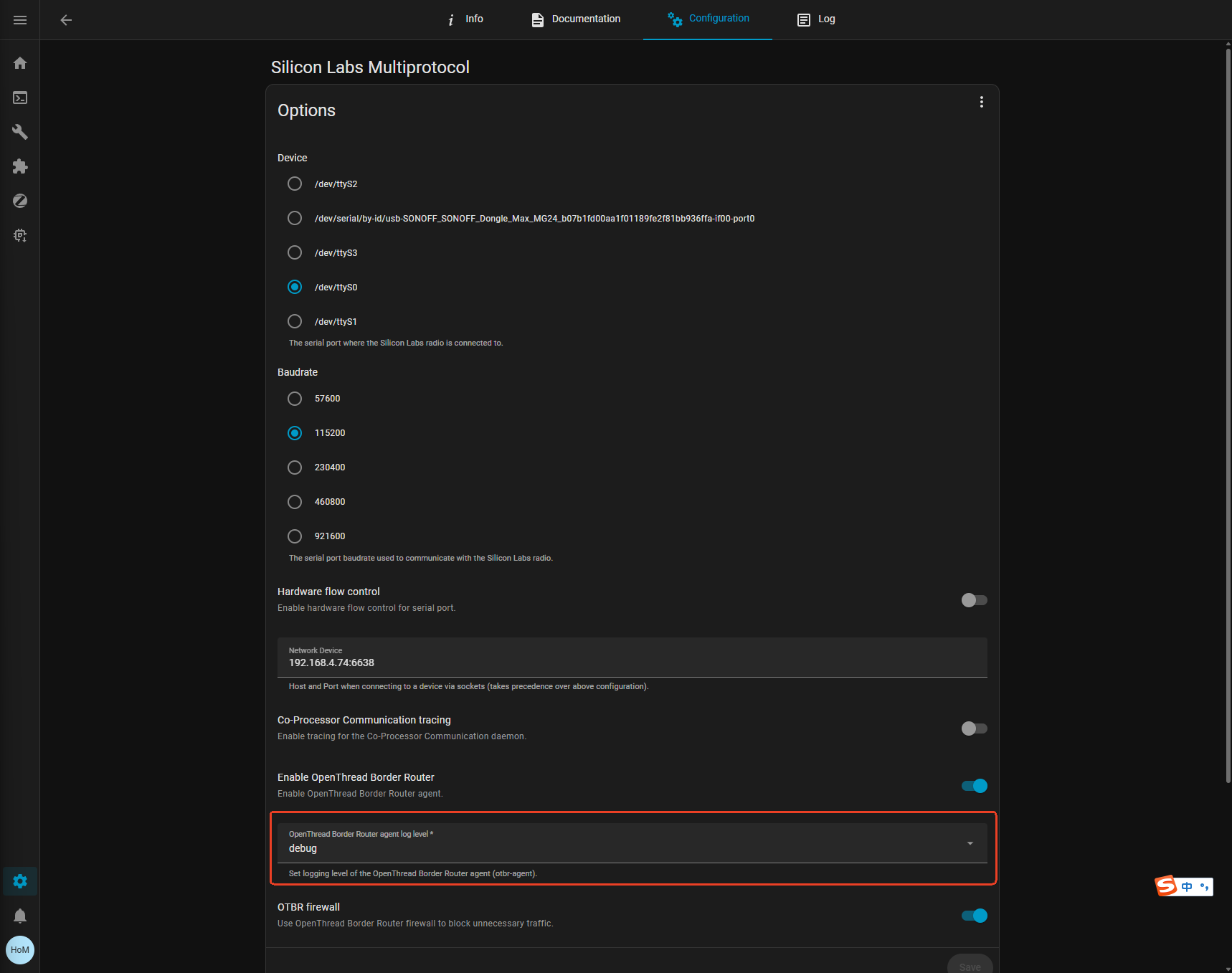

Hi, my colleague has checked the log but it’s too vague. Would you please set the OpenThread Border Router agent log level to debug through HA -> Settings -> Apps -> Silicon Labs Multiprotocol -> Configuration page?
Ok, I can try, but I have no thread devices at all.
