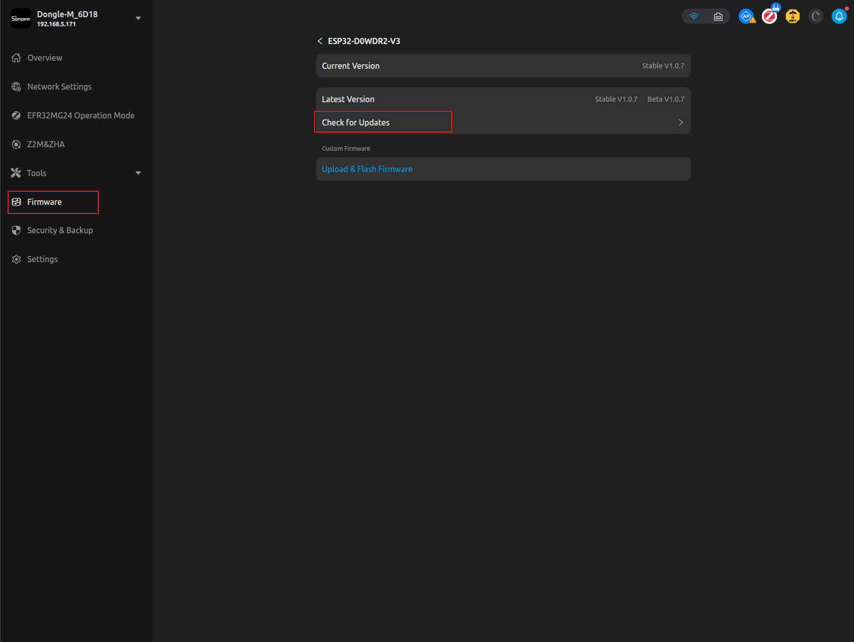

I just bought a Dongle-M and connected it to a USW Flex 2.5 PoE. I migrated ZHA from Dongle-P to Dongle-M. Everything was working fine.
I saw an update from for the dongle ESP32 to 1.0.7. After that, everything stopped working. I can ping from HAOS to Dongle-M, and the port is available when I check with the netcat nc -vz HOST PORT command. Auto-discovery even works, but I can’t connect ZHA to Dongle-M. I’ll be rolling back the version today.

My Dongle still shows version 1.0.0, not sure where you are getting the update from, can you share please ? All of my Dongle-Ms are not working, i still get the CRC error on it trying to establish a connection…
Dongle-M can be updated directly through its web UI.
You can also update it via Sonoff’s online firmware update platform:
Upgrading the ESP32-D0WDR2-V3 firmware to V1.0.7 broke Zigbee2MQTT over PoE Ethernet on my Sonoff Dongle M.
After upgrading, Zigbee2MQTT failed immediately after the initial handshake with these errors:
zh:ember:uart:ash: Received frame with CRC error
z2m: Error: Failed to start EZSP layer with status=HOST_FATAL_ERROR
The same dongle still worked when I switched from Ethernet/serial to direct USB, so the Zigbee coordinator itself and the MG24 firmware were fine. The issue only affected the Ethernet/PoE path.
Downgrading the ESP32 firmware to V1.0.5 fixed it and Zigbee2MQTT started normally again.
Thanks for the feedback. I also downgraded to 1.0.5 and it started working and then i upgraded back to 1.0.7 (all on Ethernet). It now works again…
