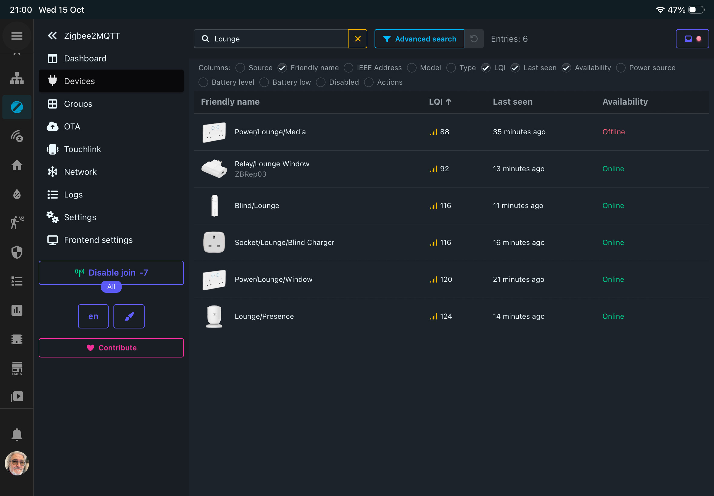

All the Aurora wall sockets and standalone sockets/plugs are showing as offline, ie 90% of my mains powered devices.
They are currently showing last seen as 12 hours ago.
BUT, I can turn the sockets on off, and can set the brightness of the status leds!
Not bad for devices that have been offline for over 12 hours.
Also weird is attempting to put the bridge into Pairing mode can take up to 20 button presses while receiving Broadcast error ‘busy’ messages.

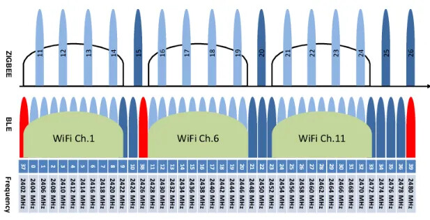

There are many factors that can cause Zigbee2MQTT instability, including host hardware, sub-devices (some devices frequently send garbage data leading to crashes), sub-device density, and network environment. I even found that the activation of the range hood at home can also interfere with the 2.4G network.
Below is the corresponding relationship between Wi-Fi channels and Zigbee channels. If you switch your Wi-Fi to channel 1 or 6, I suggest you change the Zigbee channel to 20 or above.

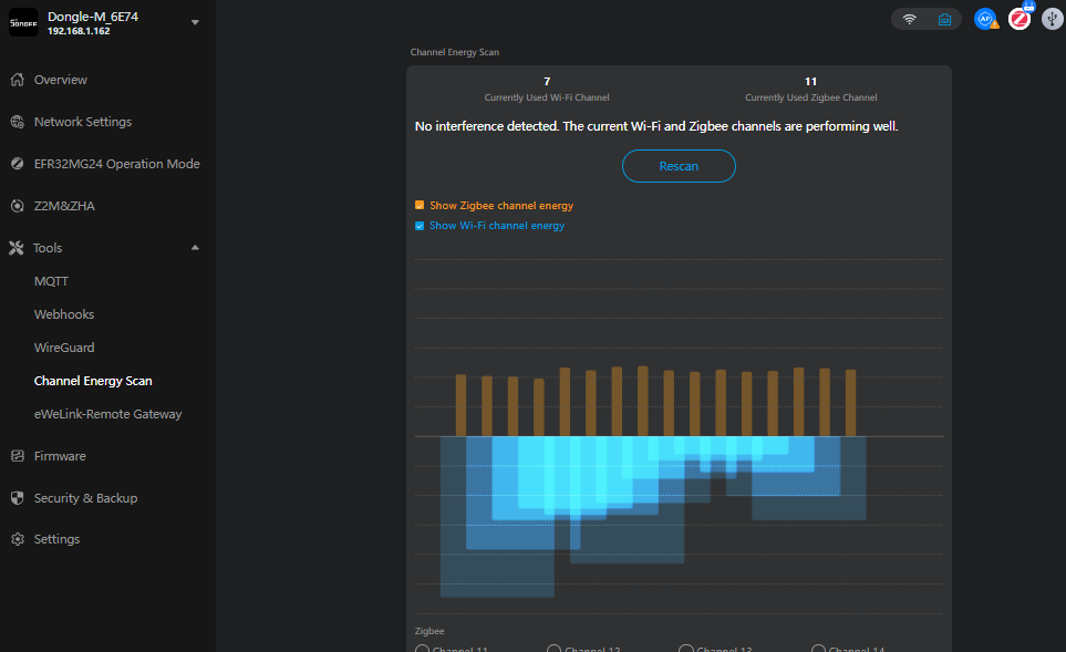

By the way, you can also use the Channel Energy Scan function of the Dongle Max to test the interference in your network environment.
