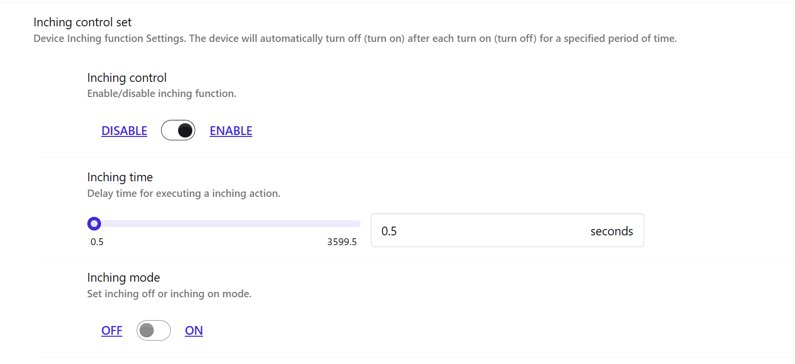

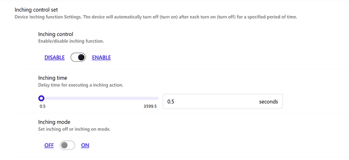

Sonoff KBD Mini - Inching control set not being exposed in device
The entities for the inching control set are not being exposed in the HA device.
I have had to modfiy the parameters in Zigbee2MQTT for the device.
I want to raise an issue, but not sure where.
Is this a Zigbee2MQTT issue not exposing them to HA or HA rejecting them

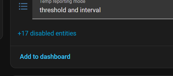

Are you sure that they aren’t simply disabled in the HA device page? Some entities (like LQI) get disabled by default.
yep, pretty sure

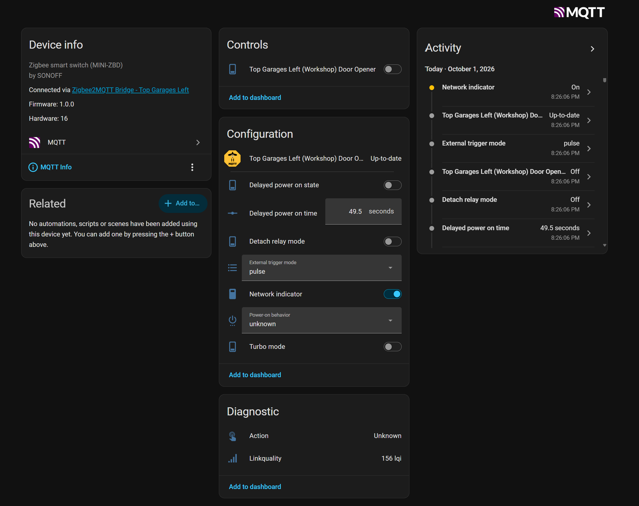

Toggle it in Z2M & see if you get anything in the activity section of the device page in HA.
If you don’t, you might wanna delete the device (with force remove), restart HA & re-pair it
Thanks, I have tried that, not changing.
With a little help from ChatGPT, just diagnosing it at the moment.
Any changes in MQTT are not being represented in HA, not just the inching control set. ANY.
MQTT is pushing out inching control set as well, so I think this is more fundamental problem.
