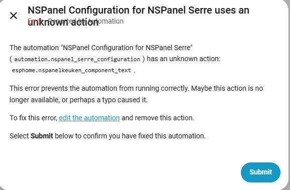

I have a strange issue when I create a new NSpanel configuration. I have one running without issues for a while now, but this new one drives me a bit crazy.
This is the error, after creating a basic new config…
The yaml is this:
alias: NSPanel Configuration for NSPanel Serre
description: ""
use_blueprint:
  path: Blackymas/nspanel_blueprint.yaml
  input:
    nspanel_name: e3cc7b51ea8c8cf031c5bba
    language: nl
    date_format: "%A %-d-%-m"
    timezone: Europe/Amsterdam (CET-1CEST,M3.5.0,M10.5.0/3)
    decimal_separator: ","
Any idea how to solve this?
Many thanks in advance.
This is usually related to Home Assistant naming the services differently than naming the entities inside the device.
Please go to Settings > Developer Tools > Actions tab, then type “_component_text” on the action name and you should find the name it is using for this specific panel (you will also see the name for other panels, just ignore those).
When you have the proper name used on the actions, you can find the “Override name” (or something like that) at the very end of your Blueprint settings and try to add the name you found.
If that isn’t working, please report as a bug on GitHub and share details about your panel’s yaml.

By chance, have you found the solution to this? I am having the same issue. -Thanks
I don’t remember exactly, but it had something to do with the naming of the nspanel device.
Thanks. I played with it some more and deleted out the setup I had. Paid attention to the naming and all while reinstalling it and all went good. No more errors.

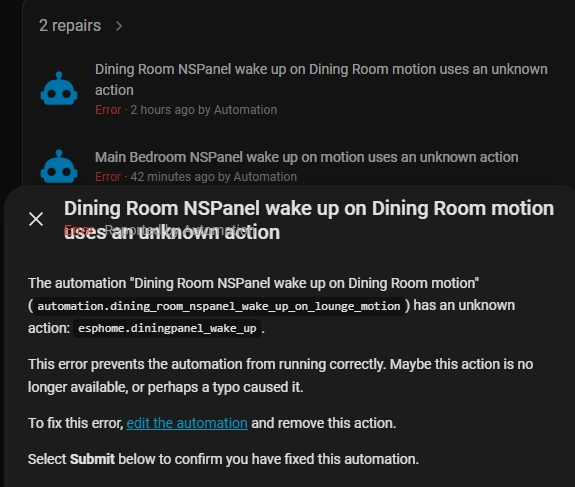

Hi Edward. I have migrated to NS Panel Easy and all went smoothly and works perfectly, except the _wake_up action is missing in your config. I looked in the actions in the developer tools, all the actions are there except _wake_up. Any suggestions?
Keep up the great work!
Please add include_action_wake_up: true to your substitutions and flash it again. :wink:
substitutions:
Thank you very much, it worked. I searched for it under open, should have search also under closed. :grimacing:
