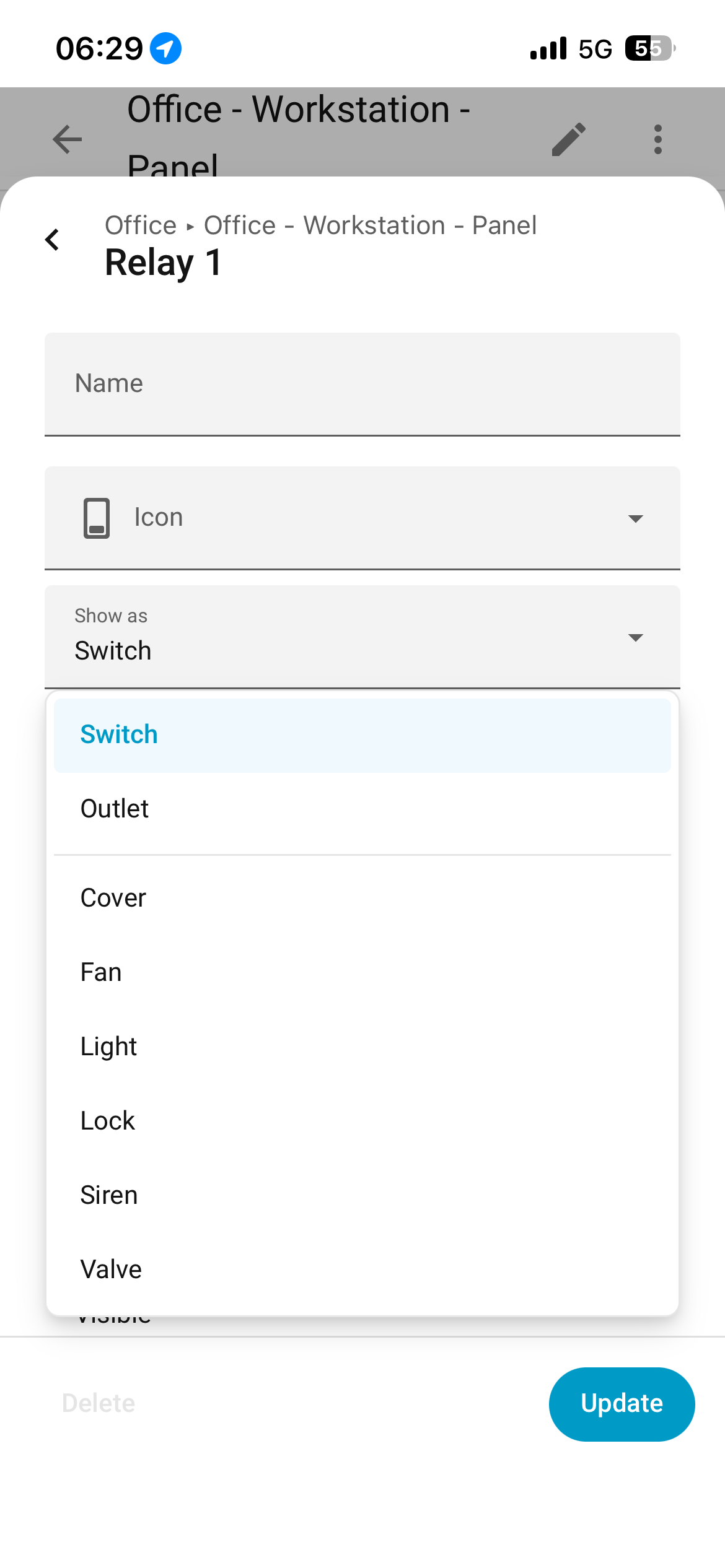

Probably the easiest would be setting to show the relay as a light in Home Assistant side.
You can open your panel’s page (under Settings > Devices and services > ESPHome), find the relay at the top, open it’s settings page (the gear icon in the top when showing the relay) and select “Light” on the “Show as” dropdown:

Thank you for the post.
It was one of my option. This is a valid easy workaround.
