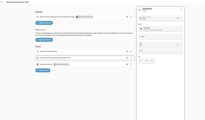

I’ve got a SONOFF SNZB-03P and was unable to get the bright/dim from the dropdown too.
So I just wrote “dim” in it, and it works.

My fix for that is insert a 500 millisecond delay before read the luminance state of the sensor, works pretty well.

I had similar problem, but was not able to “write” anything in the GUI, just got the empty selection list, when clicked on the “state” field.
My workaround was to leave it empty, select “edit in yaml” in the Three-dot menu in the top right corner.
From the generated yaml:
conditions:
  - condition: state
    entity_id: sensor.kokken_lys_sensor
    state: []
actions: []
I then manually edited it to (Note the state is case sensitive)
conditions:
  - condition: state
    state: Dark
actions: []
Then when I go back to visual editor (using the three-dot menu), i see that the state is partly visible there now.
(“Og hvis” → “And if”)
I say partly because if I select the condition to get the edit dialogue I see this.
And I still get the empty choice list if I select the “state” field.
But anyway i looks like it works now :slight_smile:
