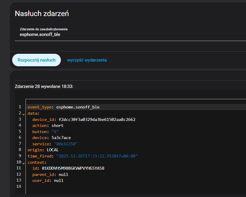

This button can be integrated via BLE proxy: Sonoff BLE - SwitchMan R5, S-Mate, S-Mate2 | ESPHome Devices. Full local integration.
Thanks for the suggestion, but this is a completely different integration path.
The screenshot you posted shows an ESPHome BLE integration (esphome.sonoff_ble events), which requires an ESP32 BLE proxy and works over Bluetooth.
This blueprint is specifically for the eWeLink Remote add-on using MQTT, with stock R5 firmware, no ESPHome, no BLE proxy, and no flashing involved.
Both approaches are valid, but they don’t overlap technically and are not interchangeable.
So while ESPHome BLE is an alternative solution, it’s out of scope for this blueprint.
