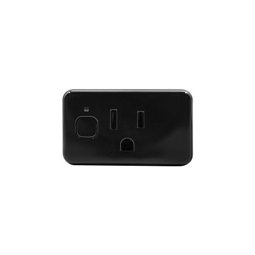

I have a number of them, build the adapter to reflash them for ESPhome, and have been pretty happy with them for single outlet solutions
I need some more, stick with the S31 or has something come along that is better?

I’d go with the S31. Good value.

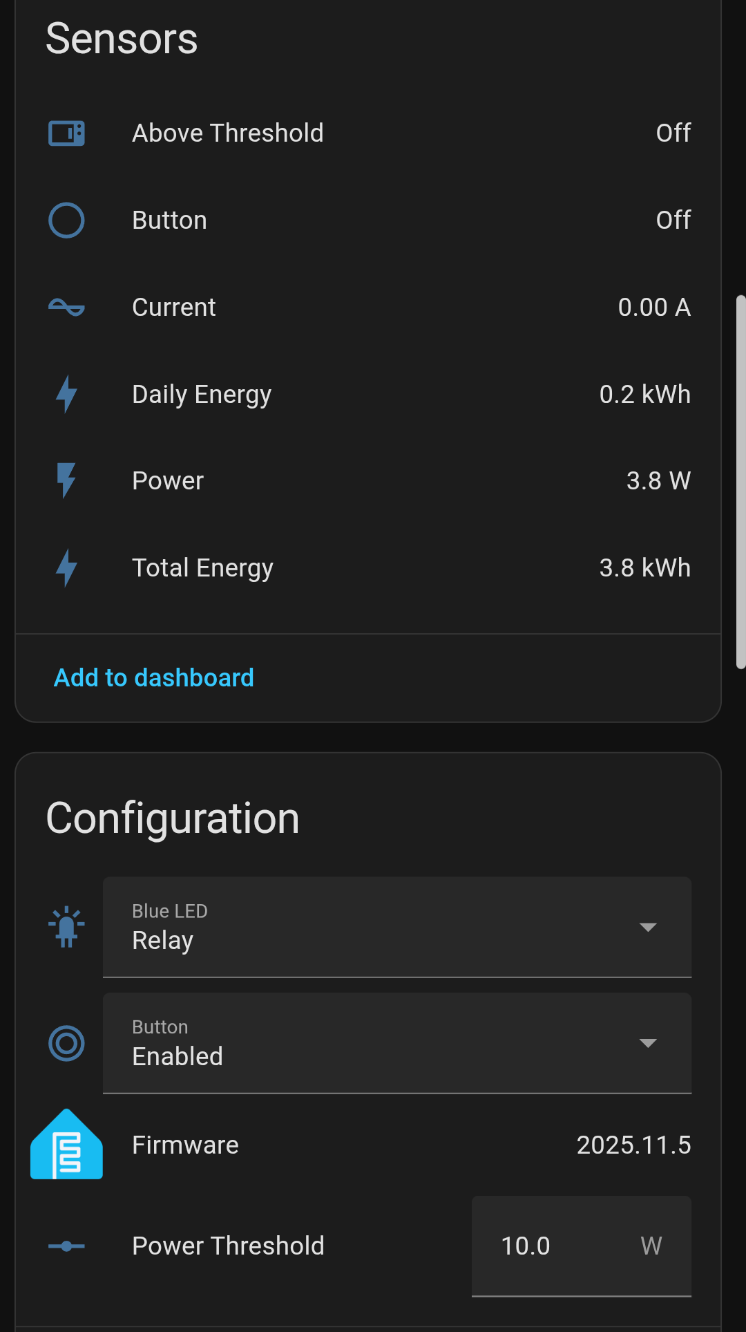

I flashed mine with ESPHome to get full control of them.
Actually, I still have one S31 in the original setup so that I can reach it and restart my HA server in case I cannot reach the server itself and I need to restart it - that has not happened for way more than a year by now, but there was a time when it happened about once a month.
What do you gain with flashing?
Full control over the sensors I want to see, e. g. adding a threshold sensor, setting when the blue LED is on, enabling/disabling the physical button.
