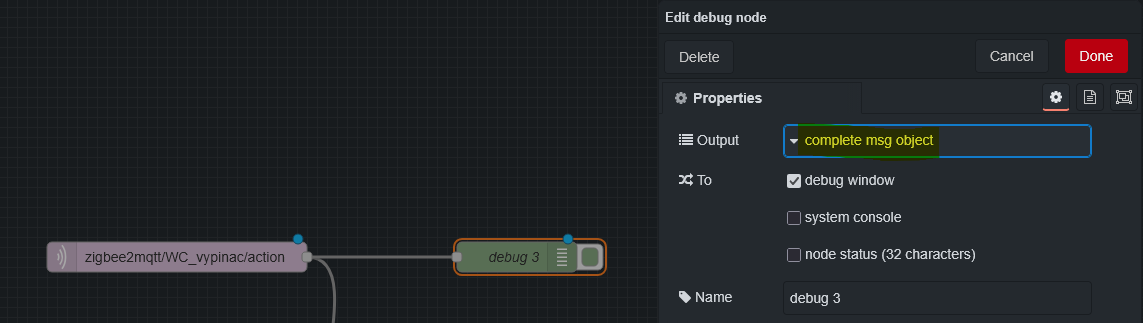

SONOFF SNZB-01P switch problem
I'm trying to connect a switch in node-red, which I connected without problems via zigbee2mqtt. The output I get is signle/double/long.
unless my HA went wrong, I had it like this - a red square. But it doesn't work that way for me now.
I'm trying to set it up according to this video https://www.youtube.com/watch?v=AjF80G9abxE which seems to be pretty easy, but it still doesn't work. I don't get any message in debug4 when pressing

Since it worked in the past and I don't see anything in your flow that is problematic, my guess would be that something changed with the way the switch reports it's state. Connect a debug set to complete message object, deploy and then try the button. Post the output of the switch.
No reports. Nothing
You'll need to look at z2m to find out why there is no message. Maybe the topic changed?
