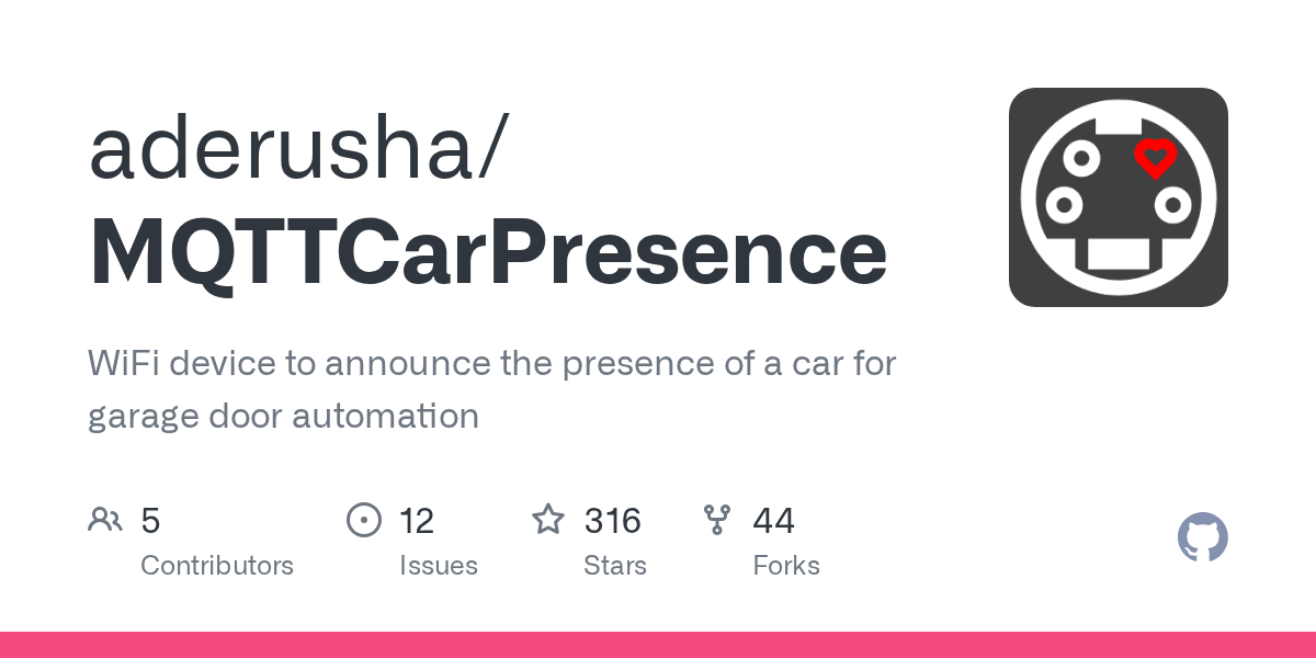

I was looking for a Wi-Fi button earlier and could not find one. The closest thing I could find were Bluetooth buttons. Can you recommend a wifi button?
-Thanks
Thank you I'll check it out.
