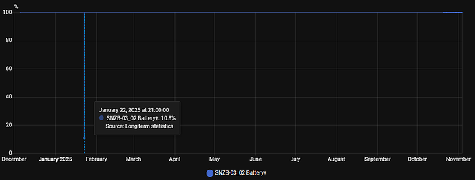

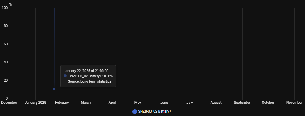

I’ve had some experiences with Zigbee devices, SNZB-03s included, where the battery percentage never decreased from 100% except just after replacing it:
And again, it’s been 100% ever since :confused:
