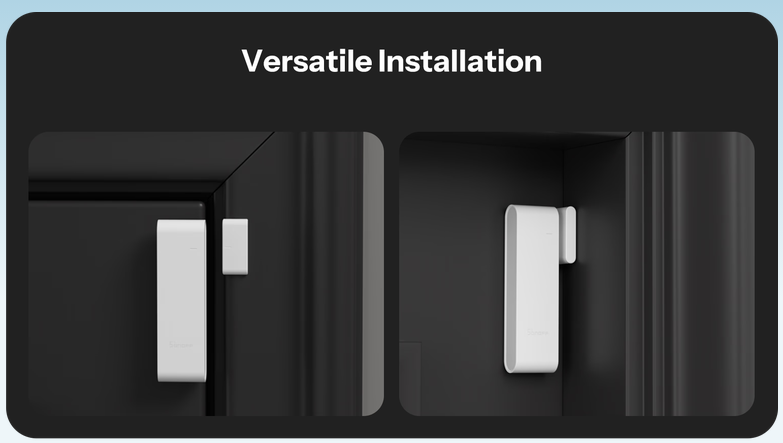

Problem 2 in detail
I recorded a short video: https://youtu.be/FH2OD0Sem2g
The orientation of the sensor relative to the magnet makes no difference. At 1:07 you can see me changing it, and I tested further orientations off camera with the same result every time.
Why this matters: if the magnet sits on a window frame, you can close the window and the sensor will still show it as open. Or you get so many messages that the actual “window is open” event is buried among them.
What makes it worse is that exactly this type of installation is shown on the Sonoff website.
The installation on the right can lead directly to that problem:

Problem 2: Move the magnet away from the sensor so it only just registers as contact: true when the window is closed. If that still doesn’t work, try playing around with debounce or X* settings in Z2M.

I will do some more testing and rearrange a few installations. That is not an option for the garage door, though, and in the end it should not have to be the solution anyway. The sensor should report the correct state regardless of how the magnet approaches it.
