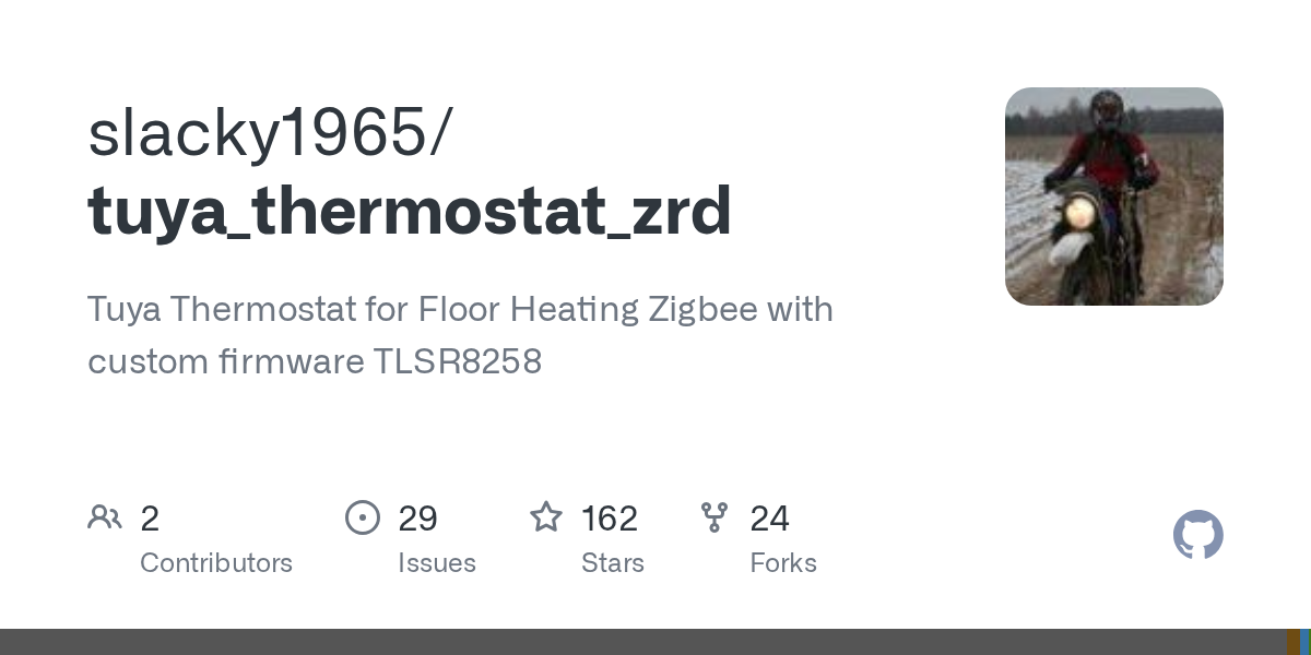

Sorry it was MOES, I got that mixed up but I found a cure in case anyone needs it here:
