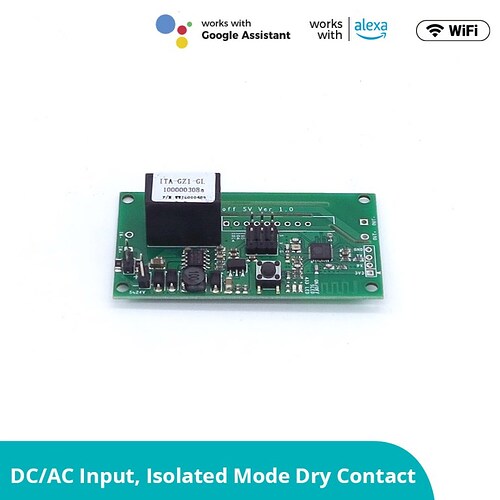

Hello All,
For motion automation without custom firmware and original eWeLink firmware, I would like to use the Sonoff SV with a standard PIR (dry output or any voltage).
PIR sensor triggers on motion detection
Sonoff SV changes ON/OFF state
eWeLink Scene reacts to that state (to trigger other connected devices)
I am looking for the correct setup and wiring on the Sonoff SV.
any help would be appreciated. Thanks.

Does ewelink support any inputs? Can you switch the relay with that onboard button?
Thank you for your reply.
I am not looking to turn devices on/off with the Sonoff SV, but to turn on/off other sonoff devices, while triggering the SonOff SV with a standard dry contact from a PIR.
PIR motion → trigger Sonoff SV → eWeLink Scene → turn on another Sonoff for X minutes.
It seems that the onboard button is the only input that eWeLink firmware actually monitors. I will try to connect (soldering) to the button and test it.
I don't know your device, but since that button is the only one onboard, it probably has multiple functions. Something like factory reset on long press is common on sonoff devices. If so, adjust your PIR timing carefully.
