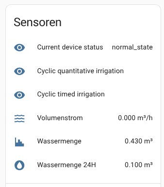

My measurement this morning showed a flow rate of 0.300, with 20min irrigation translates to 0.100 m^3 (100 liter), and my utility meter showed a consumption of 112 liter, so it seems accurate enough.
To find the water volume, you can set up an integral sensor to give you the total amount of water, and then a statistics sensor to give you the delta per 24 hours, to display the daily amount of water your plants receive.

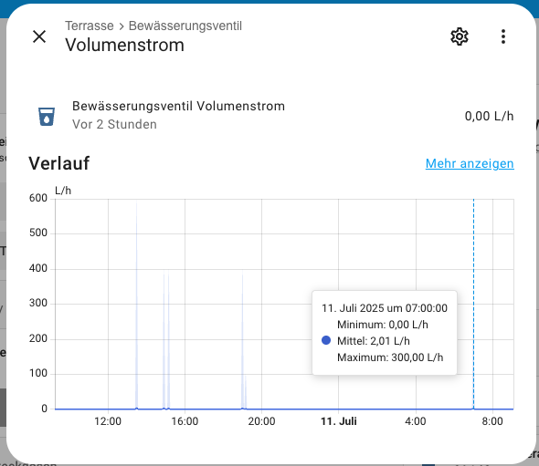

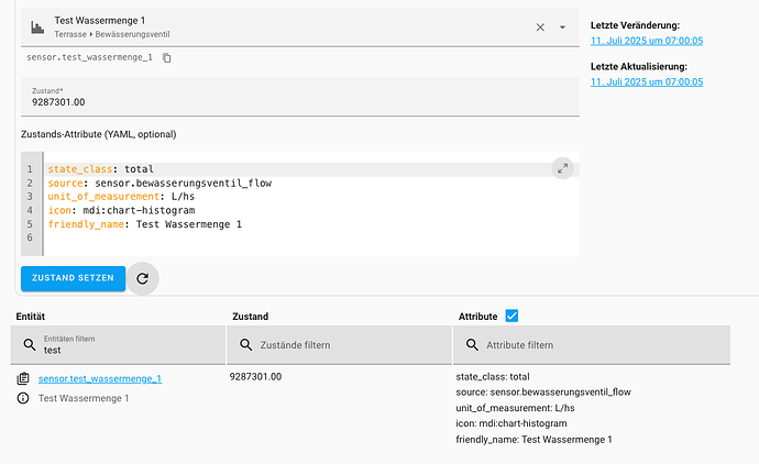

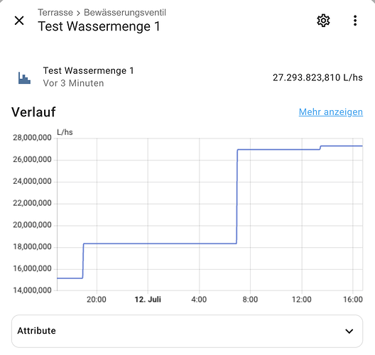

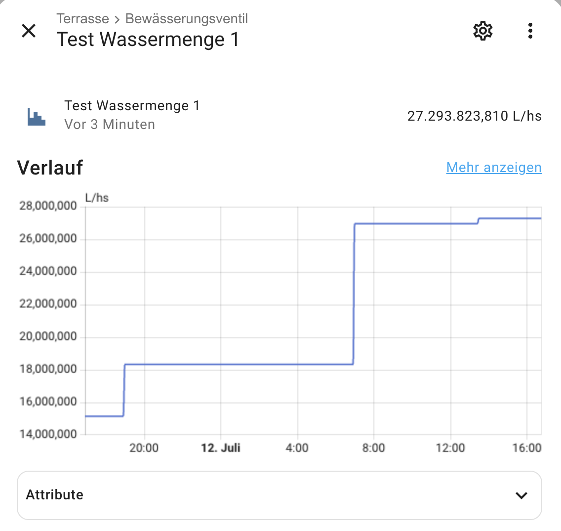

That’s exactly what I need. When I try to create this, I get a much too high water consumption, as the sum is formed using the maximum of the volume flow. However, the maximum is only reached at the beginning, when the valve is opened. The total should be calculated using the average of the volume flow. Can you show me how you have implemented this?
The water flow value is far too high:
Maybe it is calculated from the maximum flow, that is shortly after the valve is open.
How can I calculated the water usage from the medium (Mittel) value?
I probably haven’t fully understood how I can display or calculate the water usage from the flow value.

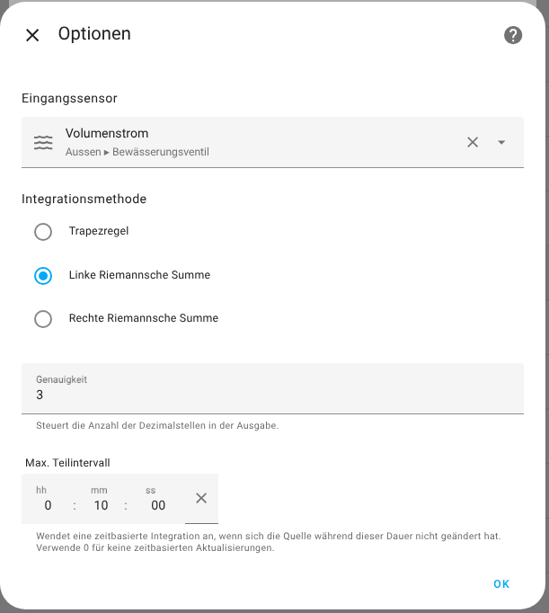

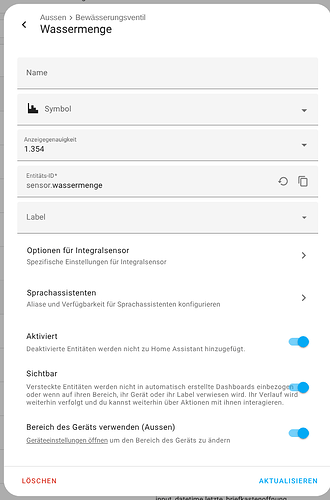

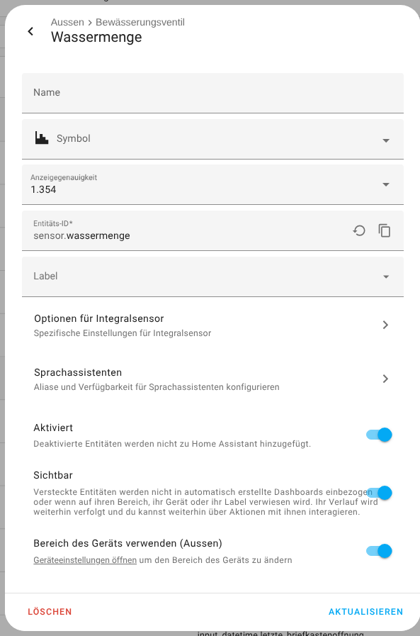

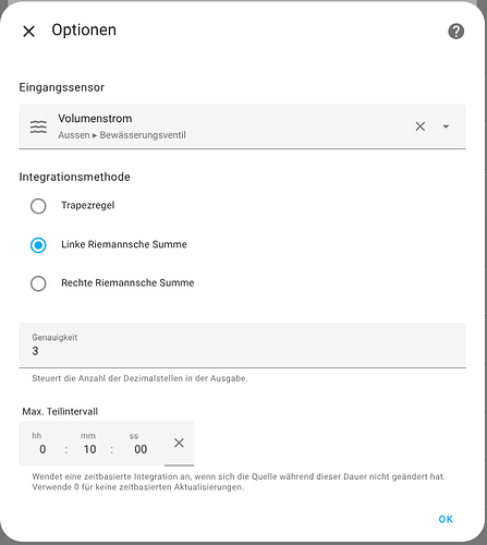

I could not find a way to display the yaml, so here are two screenshots with my integral sensor.
I am not sure about the integration rule, I am now trying the trapezoidal rule, and compare.
Thank you.
I have copied your configuration, but it still displayed much too high values. Maybe my Sonoff SWV is not working properly.

I guess the problem is the flow sensor. When I switch on the valve the value of the field “Flow” is shortly displaying something between 0.1 and 0.3 m³/h. After 0.5 seconds the value is 0 m³/h.
I use this valve for a drip irrigation with a flow of approx. 10-20 l/h
Why is the field “Flow” not permanently displayed the water flow in m³/h?
Because 10-20 l/h = 0.01-0.02 m³/h, and the device is probably only reporting at a single decimal place.
Read the above posts - the SWV seems to be reporting only the maximum flow (when you first open the water) up to a single decimal point.
Thank you! I opened the outlets at the plants a little and voila, I can see the flow. Unfortunately, the Sonoff SWV is not so precise.
