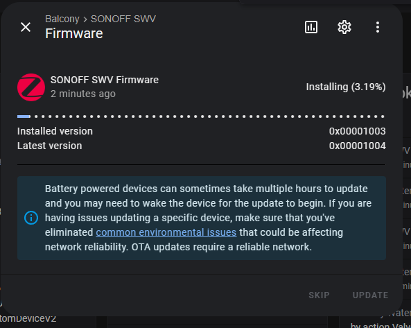

FYI, I found these instructions and then modified them so that I could update the firmware on my Sonoff Smart Water Valve (SWV).
I successfully updated from 1.0.2 to 1.0.4

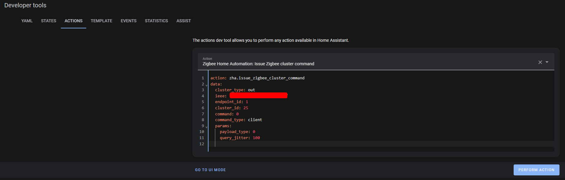

### Run the command below against the device to get it to detect the firmware update.
action: zha.issue_zigbee_cluster_command
  ieee: ’xx:xx:xx:xx:xx:xx:xx’ #add the IEEE number for the device.
  endpoint_id: 1 # Endpoint id for the OTA cluster.
  cluster_type: out
  command_type: client
  cluster_id: 25
  command: 0
  params:
     payload_type: 0
     query_jitter: 100

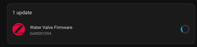

Then it showed up to firmware update.
Updated sucessfully with your help MaikaiLife Shaun. Thank you.

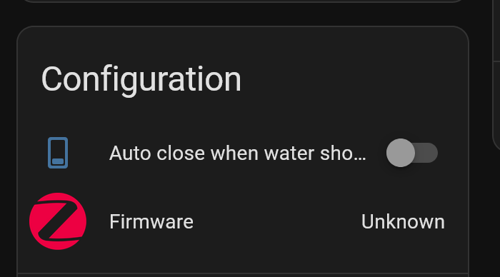

Does anyone know how to get the option to deactivate the auto_close option with zha?
Tried to use zha toolkit for getting the maybe hidden attribute and set it with it, but without success. It seems it is not available with that option.

The switch for SWV appeared in HA 2025.8.0, so there should be no need for installing from git anymore.
Works fine with ZHA and Zigee2MQTT No need to install any additional quirks.
As of 2025.9 ZHA also has a toggle to turn off the auto shutoff that annoyed so many. the SWV is designed for irrigation primarily, so when no water flow was detected, it sensed it as a problem and shut the valve after 30 minutes in this state. ZHA and Zigbee2MQTT both have an option to disable this function now. I have not used Zigbee2MQTT, but it works fine in ZHA natively out of the box
