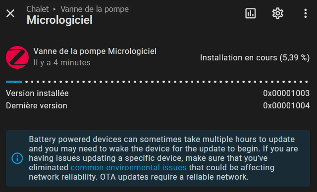

I just installed Home Assitant and added the device. Now how can I update its firmware ?
Confirmed, once the OTA settings in configuration.yaml are done, this device does need the extra things set using ZHA toolkit for ZHA to pick up the firmware
I can confirm that MaikaiLife Shaun’s method works correctly on Home Assistant 2025.12.3 after installing the ZHA Toolkit integration through HACS.
Just did the update config as mentioned above and after a restart of HA the update was already listed. The extra step with ZHA toolkit seems not to be required any more with 2026.4.2.
