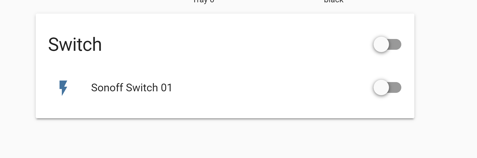

Notice something strange with my switch in overview;
Hopefully we can get to a solution.
