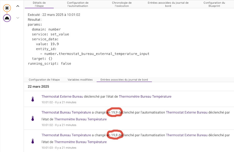

I observe a weird (but not serious) bug: when the external sensor reports 19.9°C (and only in that case), the automation always adjusts it to 19.8°C…
It was a known issue, and it’s already fixed! The fix is available on the Z2M dev branch, or a few days later in the next Z2M release.

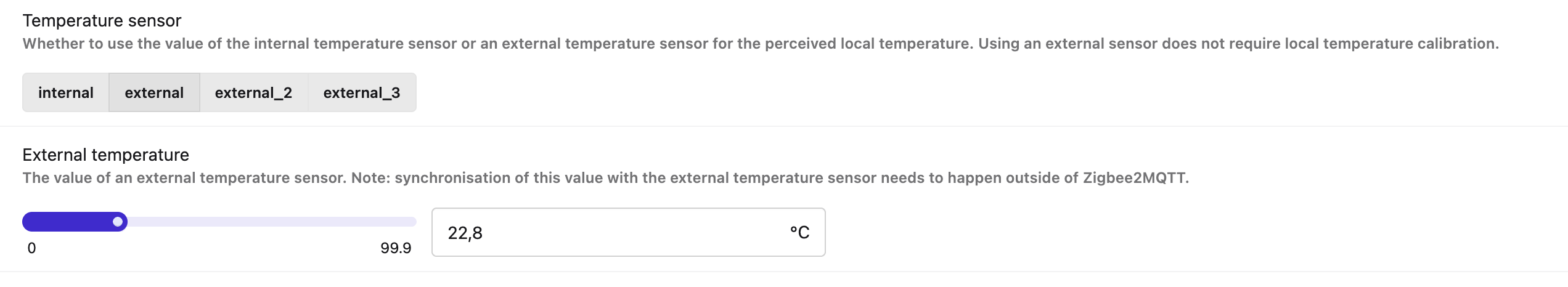

Hello. Referring to the comment at this link: Sonoff TRVZB: expose external temperature sensor attributes by photomoose · Pull Request #8873 · Koenkk/zigbee-herdsman-converters · GitHub, has anyone figured out the 3 external sensor options yet? There are currently 4 options to choose from in the Z2M.

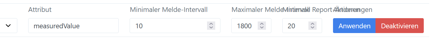

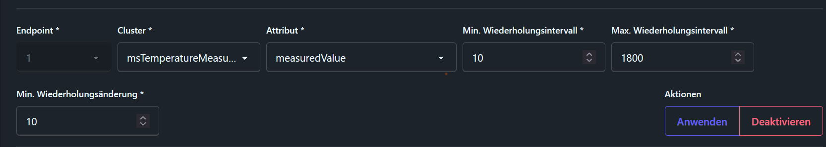

I have made the following changes in Z2M for temperature reporting (external sensor):
Maybe it will help some of you. I’m not entirely sure anymore, but I think after a major Z2M update, I had to re-add the entry in configuration.yaml once.
