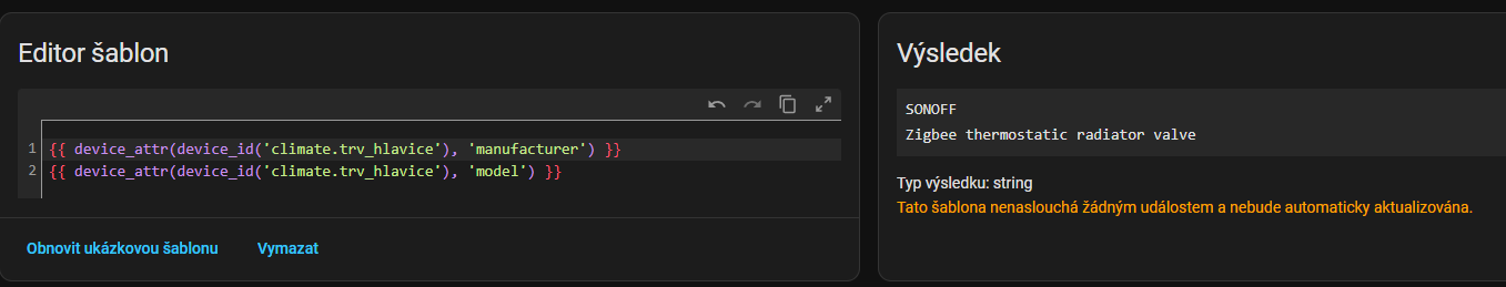

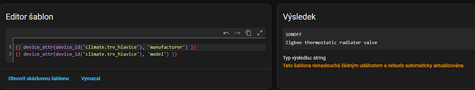

I try it with Z2MQTT, but must change MODEL filter to
model: “Zigbee thermostatic radiator valve”

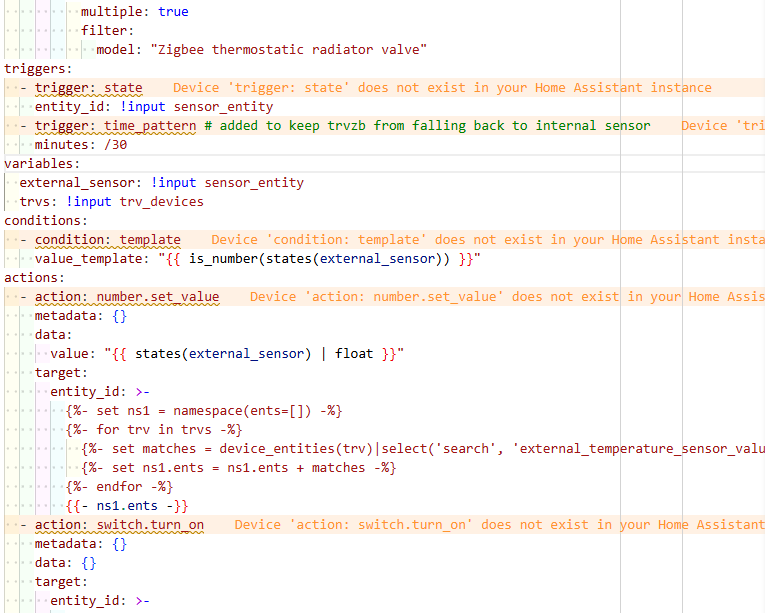

and functions in vscode editor has warnings

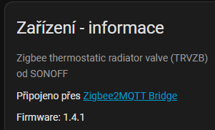

Model: the zigbee versions of SONOFF TRVZBs are all called TRVZB.
Is yours from SONOFF?
And yes, you can change the model, that is only for selection, but if it is a different type of device it will not work.
The errors in vscode are not relevant: vscode does not have the correct HA-yaml. you can check yourself: action: switch.turn_on is the newest syntax as it should be.

pls show device data from your device such as this:

zigbee2mqt have differen device info
and when I test in templates …
I have to customize this for finally showing sonoff in select …

yeah model par help … like I am showing one post up :slight_smile:

ok… indeed it seems the model name is different (I wonder whether I maybe ever managed to change this). So we can just add another model line to include them, that should help: (can’t edit to the original posting):
            - model: Zigbee thermostatic radiator valve
so new version:
