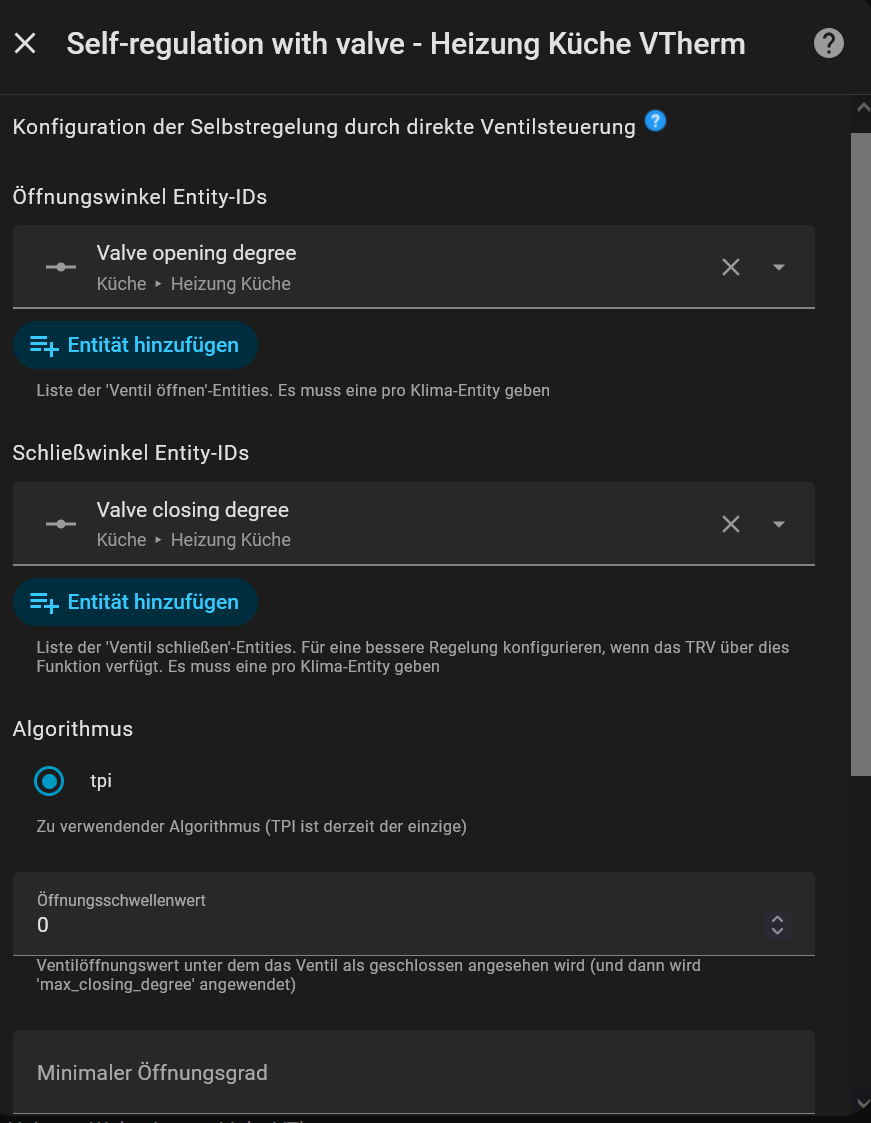

are you using only opening degree for valve change or also closing degree?#
thanks
i think i have the same problem. even calibrating every day (100% to 0% for. a minute). what is your solution for now?
Both:
Or do you mean something else?
