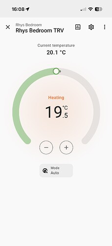

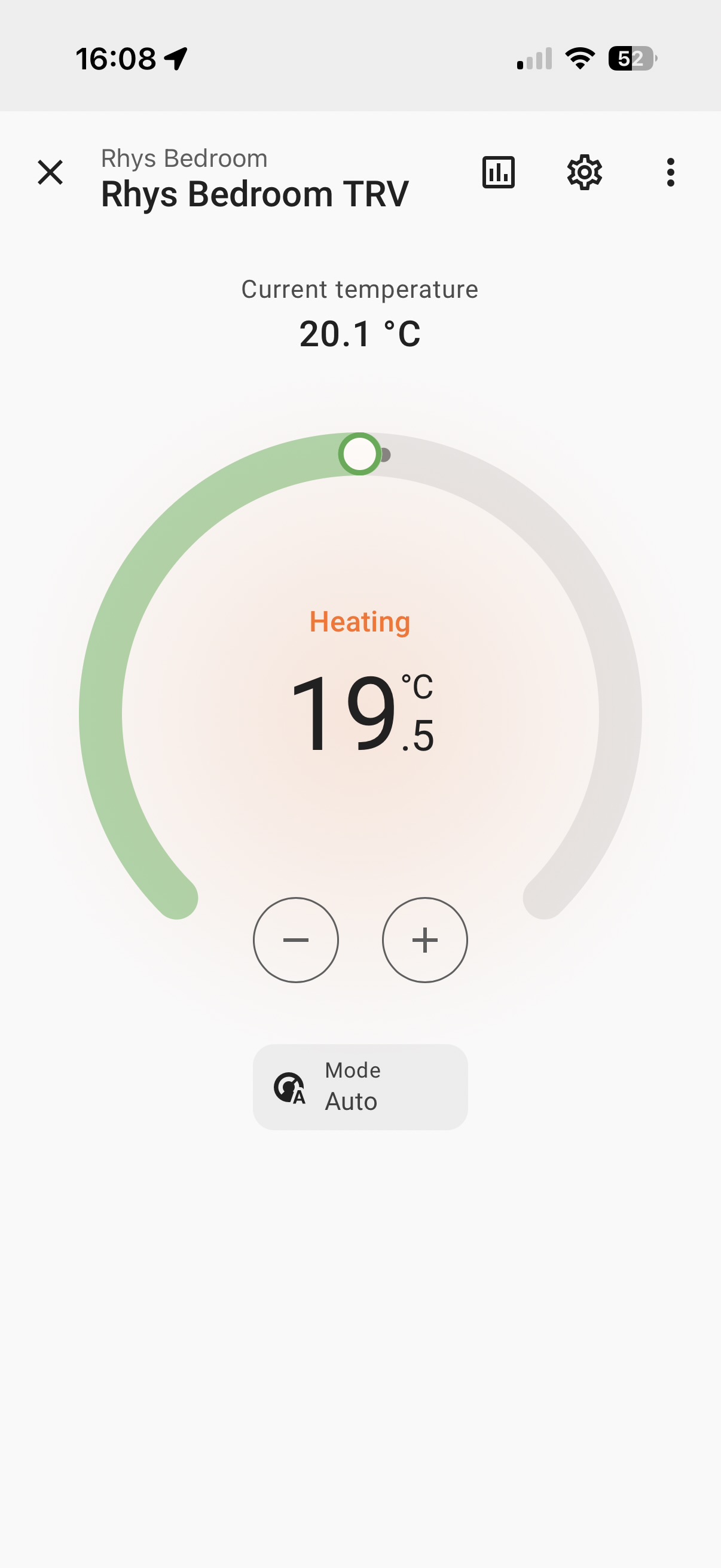

I am also getting overheating for some reason. See my son’s room below. 19.5 target yet heating still on at over 20c
Well, it could be that if smart control is enabled it will always say “heating”, since only valve opening percent is changing as valve is trying to find optimal open percentage.
But, in your case it obviously heats too much, yes.

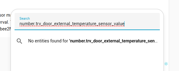

you are searching for a ‘number.', wheras a temperature sensor is usualy a 'sensor.’
